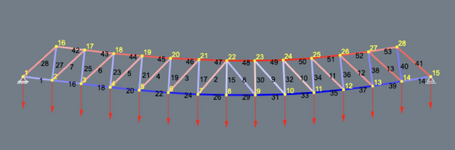

On the disaster, I think it will be found that the gangway was longer than ones they normally produced to limit the angle at low tide and no one actually designed it, they just bought a stretched 60 ft one, and never realised the trusses were different.
It's not so much that the truss type was different (the Howe truss is actually more suitable than Pratt), it's that an "L" or inverted "T" has limited viability in any circumstance. That two different types were employed in essentially the same project just makes the head scratching more ...
Howe more suitable for aluminum than Pratt??? My take is Howe is better suited for wood with larger diagonal members in compression, and Pratt is more suitable for aluminum/steel with longer smaller diagonals in tension??? EDIT: In terms of efficiency and lower costs a Pratt looks the winner for aluminum. My concern is Pratt sized members in Howe configuration will not support equal loads. Perhaps Howe distributes loading better under certain conditions. Either one can work if members sized according to configuration for specific material used.

As to the truss type, it was my impression that the Howe distributes the top chord compression across the length of the structure compared to the Pratt which concentrates the force at the center. Since buckling is likely the failure mode, that is the factor of greatest concern in this instance.

I don't disagree with your Howe top chord compression handling, and I would argue that member was not sized properly either for the Howe configuration. My guess is actual designer did not understand difference between round and square tube load capacities.
The lack of engineering and understanding the affects of geometry changes are the issue along with quality control; rather than whether Howe or Pratt design works best in this situation.

Setting camber in walkway like this can be done by blocking the lower cord to the desired shape before welding in the diagonal members. For a structure like this camber is mostly cosmetic ie it does not change the member stresses.

Cambering the deck pretensions the top chord and likely has minimal effect on the deck weld connections at the bottom chord. It also precompresses the vertical elements. As FacEngrPE (#151) pointed out, the camber is within/close to the elastic limits of the material. Once diagonals are applied and the camber stops removed, the diagonals acquire an induced compression from the structure's self weight. The key takeaway being that the structure is preloaded opposite to anticipated loading.
An interesting stress redistribution occurs when an applied load is skewed to one end of the truss. (In the example below, the load arrows do not reflect the magnitude of applied load.) I applied increasing point loads to the right, as if a crowd of patrons bottleneck at the right end of the gangway. Note vertical member 30 becomes compressed while diagonals 8 and 9 become tensile. The peak compression on the top chord also shifts to the right. This is consistent with the failure witnessed in the collapsed gangway.
I'm curious why the top chords IRL all tore (including center rail) to the immediate left of the equivalent node 23/24 connection.
