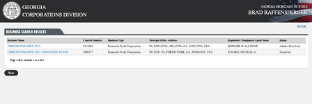

Crescent Marine brings up this in GA Crops Division Database
