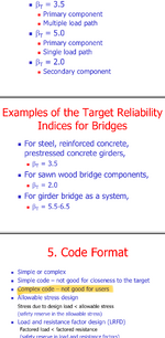

I gotta say, I was pretty “don’t mess with the code” (wrote a whole thesis about it) until I took a graduate-level reliability class. Knowing the very little that I do, now, about Turkstra’s Rule and Code Levels and such, I can’t find it in me to complain.
The code-writers know this sucks for us:
Maybe it would be best to add something to the drawings translating it: "The structure is expected to withstand the following environmental and weather effects with little to no damage or loss of use: <list them in a way that a layman understands>"
Table 1.3-1 in ASCE 7 does this beautifully. I’ve had great success pointing laypersons to it.

Really? You know a layperson who understands reliability theory? Really? I doubt most users of this site really understand it. Hey...I'm not even confident I can say that I really understand all the ins and outs.
I meant more like depth of snow, scale of a hurricane, etc. The stuff that RWW0002 was talking about.
