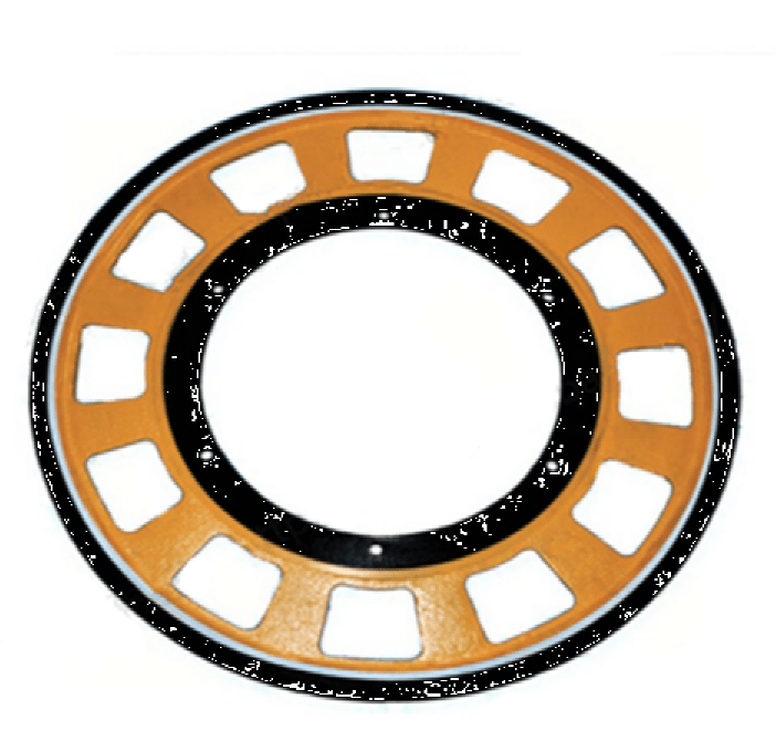

Muthu; just teasing you. You happen to have found a couple that are well maintained as there are certainly lots that don't move at the same speed. Typically the ones I ride aren't greatly out of sync as for instance you wouldn't have to re-set your hand before you were exiting but you'd certainly notice.
This is a typical handrail pulley:
You can see the rubber part that directly moves the handrail. As it wears there is a guaranteed ratio change. If they are kept up you won't notice, if they aren't there will be a difference.
