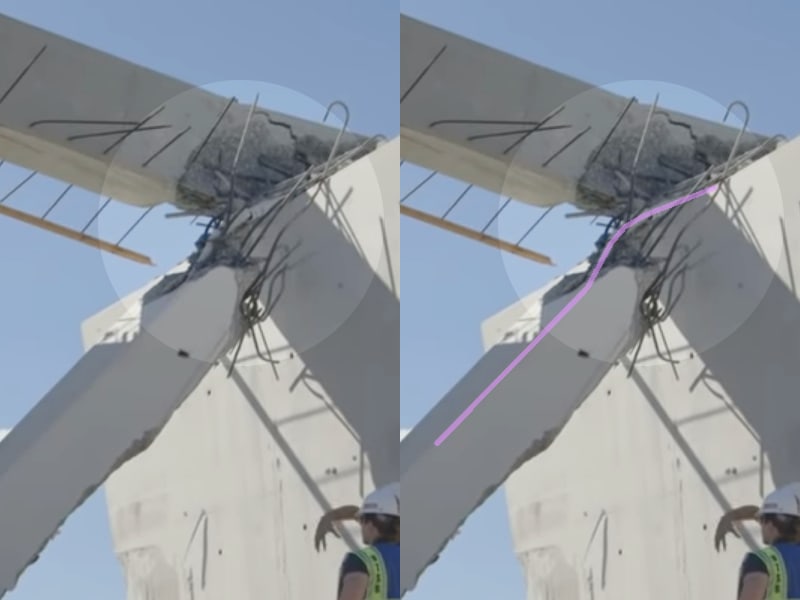

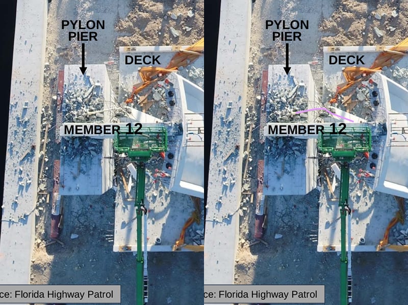

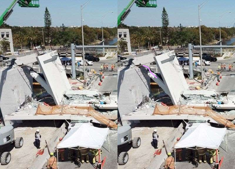

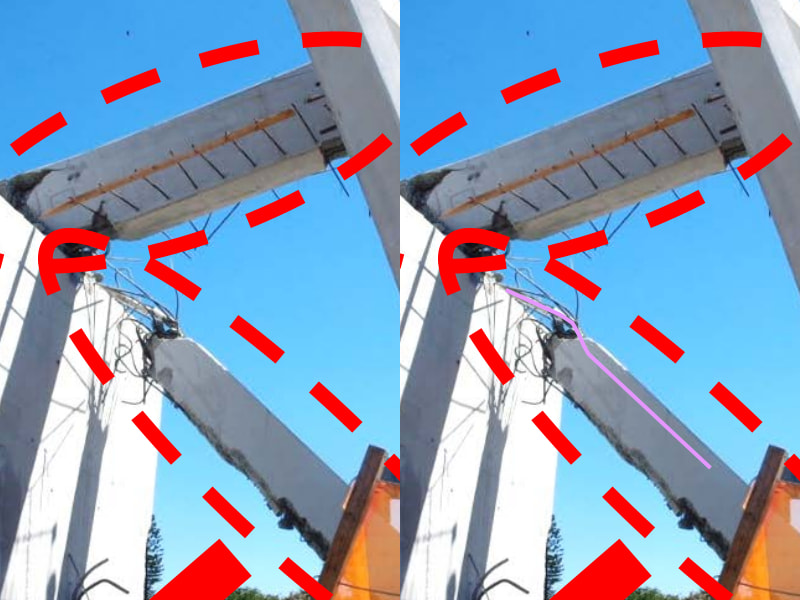

Five different vantage points of the upper PT rod in Member 11:
saikee, in response to your post, I submit the following:
What we should all appreciate is that the 11/12 node detached from the deck. The structure accommodated with various deformations and held (though momentarily) until shortly after load was reapplied to the two PT rods in Member 11. Whereas the design intended this node to be inclusive of the deck, it was not.
The detachment of the 11/12 node resulted in the lower anchorages of the PT rods having competing loyalties to the detriment of Member 11.
If Member 11 failed due to excessive load and offset ends (by deformation), the PT rods would unload their energy into the collapsed member (I believe the rods are stretched about 1.4") and then be vulnerable to deformation as the member crushed further. The different deformations of the upper and lower PT rods are consistent with this failure scenario. In fact, had Member 12(edit) the upper PT rod not deformed in this manner, it would disprove my theory.
If Member 11 pushed through Member 12, the lower PT rod would tear out of the bottom of Member 11 but Member 12(edit) the upper PT rod would be protected, at least initially.
Vance Wiley (Structural) 11 Jun 20 02:42 said:
i do not see an indication of failure of the upper PT rod in Member 11.
Interestingly, your posted image goes more to support my theory than a multitude of alternative perspectives. Your image indicates that the two deformations are in the same plane which is more indicative of a single assault than multiple assaults which might have occurred with the collapsing structure.

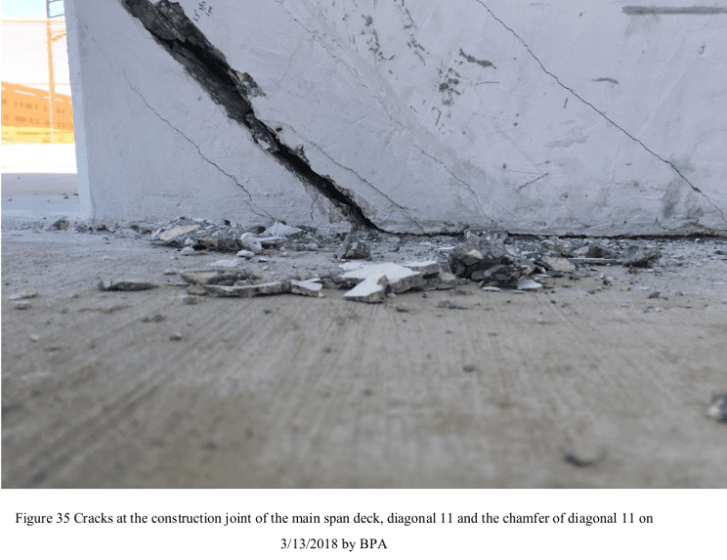

Is this the area which as supposed to be roughened?

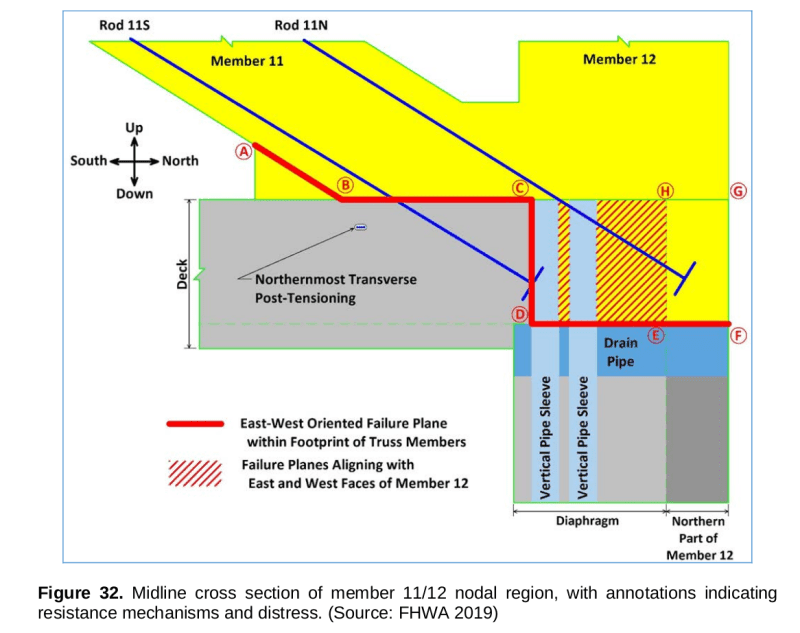

Warros, you assert as a proposition:
"Tension in the lower PT rod adds to the force on the connection."
But this is wrong. By definition, the force "on the connection" is a force that is applied BETWEEN #11 and the deck. That means we are looking for a force OUTSIDE #11, that is BETWEEN #11 and the deck. This is the shear force between #11 and the deck. It is commonly agreed that this force was about 1,500 kips (1.5 million pounds.)
Note: tension in the lower PT rod is INSIDE #11. Therefore, it is not outside #11.
The bridge would have failed no matter what the tension in the lower PT rod. i.e. The failure condition of the bridge was independent of the tension force in the lower PT rod. Failure was caused by the fact that there was no tensile steel provided in the deck that could have prevented 1.5 million pounds in #11 from travelling north.

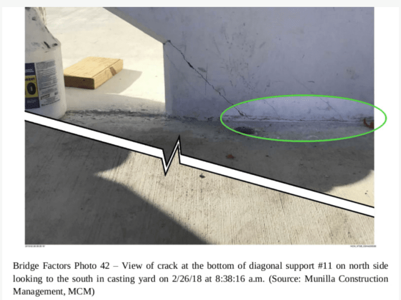

The lower PT rod was anchored to the deck below the crack.

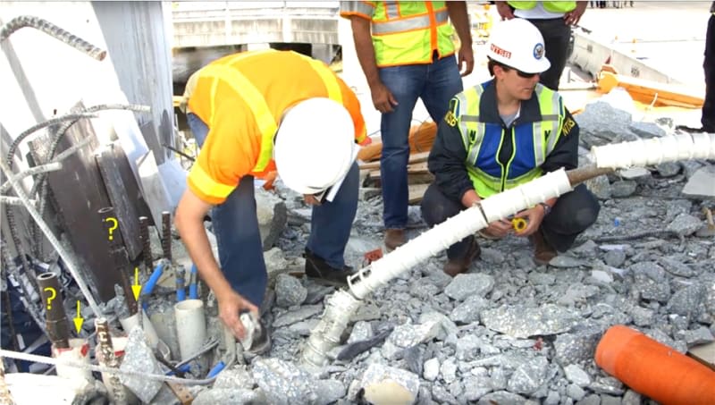

After the collapse and the destruction of a lot of concrete, the end of the lower PT rod appears to be still anchored to the deck, despite being ripped almost entirely out of member 11.
The crack is opening in a horizontal direction.
This strongly implies that the concrete had already separated and that the joint was held together by the reinforcement.
Here is the first indication of failure.

I'm confused. I thought that because the lower PT rod was anchored to the deck at the bottom, that tension in the rod created compression in the joint, but because the joint was not perpendicular to the PT rod, that a shear force was also applied to the joint? (Since the top of the upper PT rod was not exposed, I assume that it was not Post tensioned.) ((yes I know about assumptions.)

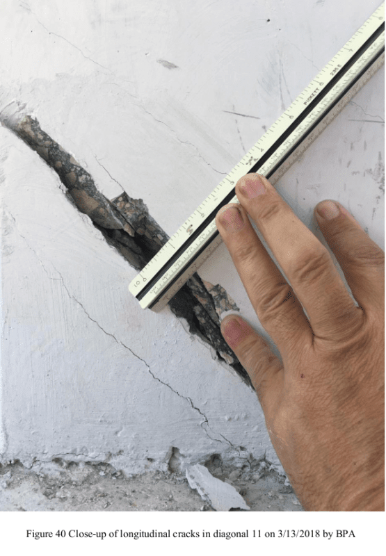

Continuation of my post:
Here the crack is opening in a horizontal direction.
Yes, it's being measured diagonally but the movement is horizontal.
If the crack was opening diagonally, the horizontal crack to the right would also be opening.
The actual displacement is greater than the measured amount.
Looking at this sketch, the lower PT rod passes through the plane of failure.
The tension in the PT rod may be resolved into horizontal and a vertical components.
The vertical component adds to the friction of the failure plane but does nothing to close a horizontal crack.
The horizontal component of the PT tension acts to open rather than close the crack.

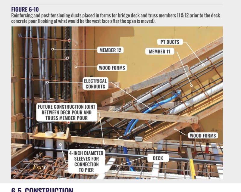

I wonder if the drain, sleeves, and conduit were steel instead of plastic if it may have held together long enough for someone to condemn it without anyone dying.

I think the point here might be that there were no gussets as there would have been in a steel truss.
Also FIGG proposes that it would be like an I beam.They seem to have forgotten that in an I beam the flanges are welded to (or rolled with) the web?
