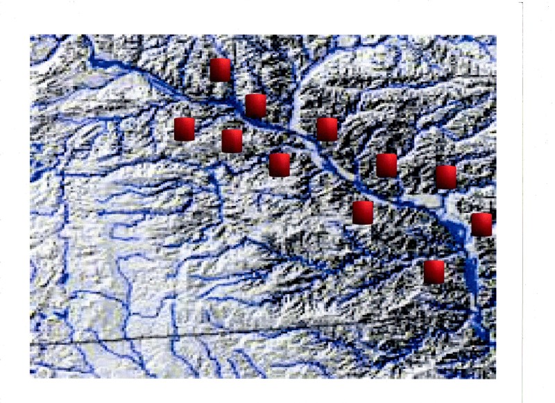

Following is a graphic
The topology of Southwest Wisconsin, the Mississippi River, and Red storage tanks.
Theoretically, each tank represents a capacity of a cylinder, 1 mile in diameter, and 1 mile deep.
From a practical point of view, each tank is actually a small damed up valley between river bluffs on the banks of the Mississippi, maybe 400 ft deep.
Wind Generators, river water pumps, solar collectors are used to fill the tanks with water borrowed from the river.
SlideRuleEra indicated a staggering number of wind turbines would be needed to just fill one tank in five years.
Construction costs of a small dam at the head of a valley should be minimal.
Not looking to dam the Mississippi and create another Grand Coulée dam, just a few small dams that, as a whole might approach the Grand Coulee as a whole.

Regarding "Determine how much, if any new energy, could offset the reduced use of hydro-carbon fueled electricity generation."
Your propsed project will have a net loss of energy. Pumps are only 60% efficiency.
As SlideRuleEra stated, pumped storage projects are only constructed to avoid the expense of a power station that is only used at peak times. Pumped storage eliminates capital costs while increasing inefficiency.
Have you ever heard of a dam project where the water was recycled back to the dam? You would only be able to recycle 60% of the water because of the pump's ineffiency.
To fill up the basins, you would have to shut off the river for 8 months and then permanently reduce the flow of the River to keep the basins filled.
The pumped storage thing as a battery is pretty cool, and used in a lot of different places.
The Mississippi is a pretty terrible place to do it though. The idea works best when you have several nearby reservoirs in series in a mountainous region.

A system of systems and subsystems, with redundant capabilities. Existing USA electrical generation is already a system of subsystems and some redundancies exist. I've got that.
Looking back, there showed have been a green line connecting storage tanks. I left out the networking capability. The networking capability consists of a pipeline to allow all storage tanks to keep close to full potential.

I though about this while sleeping. Personally, I was a little disappointed to come to the realization that on a large scale, this idea is not practical. But I also realized that if a small community with the right geography, could put it to use on a small scale on a fairly reasonable budget.
