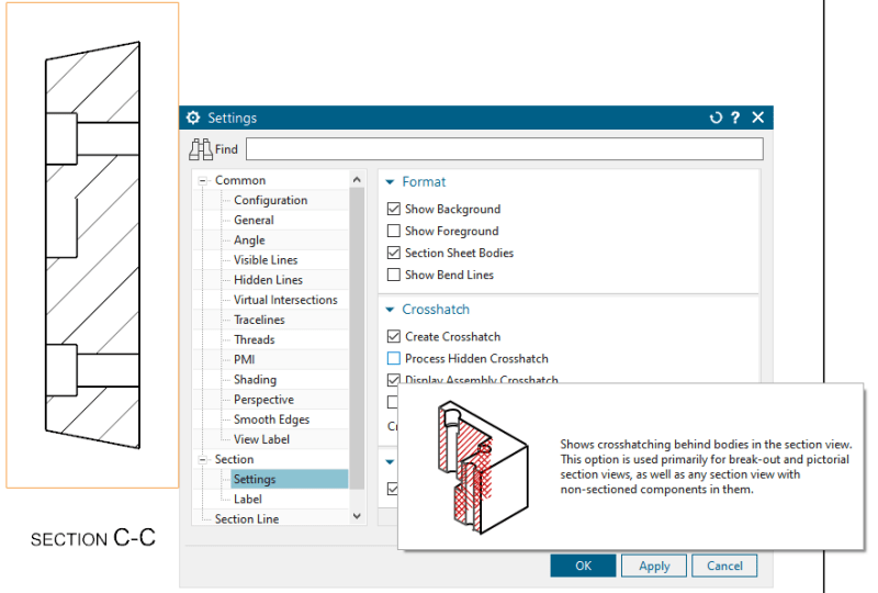

Crosshatch options grayed out
RUGmechanic
Jul 16, 2008
64
Hi all,
I have a question about my crosshatch settings, see attached image.
The "Crosshatch definition" and "Pattern" options are grayed out.
I cant't find a setting in the customer defaults or preferences to correct this.
I changed the file permissions for xhatch.chx in the UGII folder to "full control" but no succes.
Anyone who can save my day ?
Thanks in advance,
NX 1926, Win 10, HP Z820.
Older budweiser
NX8.5 & NX9.0 64bit, hp z820
 https://files.engineering.com/getfile.aspx?folder=8d339a06-f2d7-470e-9a96-c87b37b5593a&file=grayed_out_hatch.PNG
I had a problem similar to this a couple years ago, and I discovered when I logged off of NX and back on my issue was fixed.
Jerry J.
UGV5-NX1884
It seems to be file specific, not sure why.
In some parts the crosshatch options are grayed out, in other parts they are not.
Older budweiser
NX8.5 & NX9.0 64bit, hp z820
Turning off Assembly Cross Hatching when creating an assembly drawing seems not logical.Also, turning off this option did not solve the problem.
But your suggestion put me on the right track.
The trick is unchecking "Process Hidden Crosshatch". Attached file from NX 1926.
Older budweiser
NX8.5 & NX9.0 64bit, hp z820
