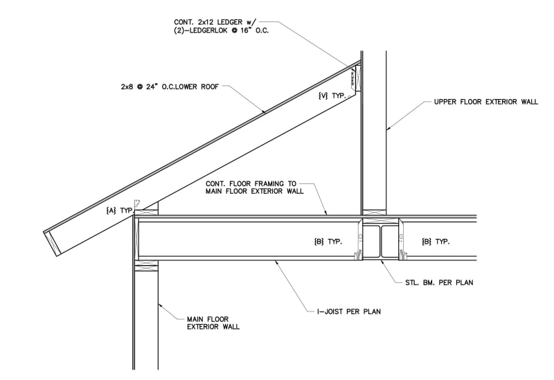

Buleek, if you can, try to continue the upper floor plywood all the way to the main floor exterior wall. Then the lower roof will just overframe over.

DoubleStud, I don't I following what you are proposing.

If the wall on upper floor is a few feet inward, that means you will have a lower roof covering the offset. I am just saying it is better to continue the floor diaphragm of the second floor all the way to the exterior wall of the main floor. This way you are not relying on the lower roof to transfer the lateral load.
Like this.
