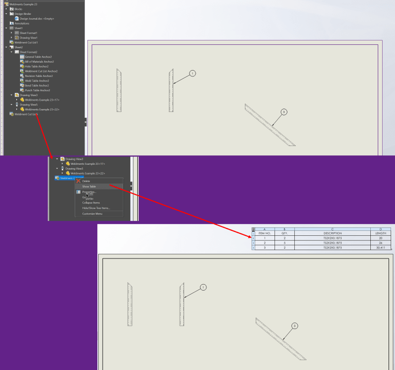

Hello,
I do large weldment parts with multiple weldment cuts and I have a cut list at the beginning with all the bodies, then I do the drafting for individual parts in later pages, would it be possible to insert a cut list for a view on the current page that will only have the bodies that are in that view that I chose with ''select bodies'' inside? I tried selecting the view before asking a cut list but it kept bringing the whole cut list.

pllmoreau - Weldments always have at least two configurations: "As Welded" and "As Machined". Since machining will not remove any bodies, normally both configurations will have the same number.
The problems I have seen is when I try to create other configurations in which some bodies are intentionally omitted.
Back to your original question. I tried this out and I cannot get it to give me a table of just the selected bodies even using configurations because all it does is hide the bodies not suppress them. If you could suppress the bodies and only keep the ones you want then it would be possible.
You could put the Weldment cutlist on the first page ballooned, then on the second page put the same weldment cutlist, but drag it off the page and hide the table. Then you can balloon the bodies and it will follow your cutlist and the person reading it will think it's coming from the first page.
I am using SW 2023. If you want to see my simple sample let me know and I will attach it to this post.

jassco: There is an option "select Bodies" when putting a weldment into a drawing. It will only show you those bodies that you selected. You can see that in my image above. He wants a weldment cutlist to only show those selected bodies and not list all the bodies in the weldment.
