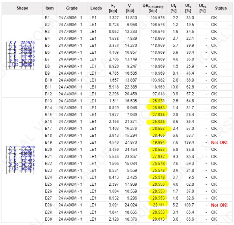

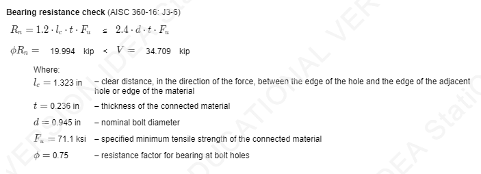

You need to check the numerical outputs of the software you are using. The bearing capacities of the bolts with doubler plates are significantly lower than the bolts without:
It appears that the program is calculating bearing capacity against the thinnest material (1/4" thickness).
Another common sense check is that all of the bolts connecting to the column are passing. You have more bolts connected to the beam side yet these bolts are failing. You shouldn't require more bolts on one side of the connection vs the other, the design seems inefficient.
Conventional connection design would assume the bearing stress of all the bolts is equal. You should be able to design this connection using hand calcs.

Bolt forces are consistent with our manual checks. There are deviations due to crudeness of our hand checks (ic or elastic method) but for me, I was satisfied. Bolts at the column side are less because they are subjected to less eccentricity.
I consulted with the helpdesk. They have agreed that it is a bug that bearing checked against the thinnest plate. I further consulted them about the force distribution between web and doubler plates and asked for validation etc. I will post if they respond.
We sorted this bug issue with client and they will accept our solution. Basically, although this is very labor intensive, we will replace the part of the web with thicker plate. Like instead of having 6+12+6 we will replace the part of the web with a single 24 mm plate (just in FEM model,not in reality). I believe idea statica will resolve bearing issue in next versions although they said it might take weeks.
