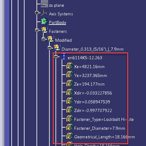

Hello All,
I am new to the VB programming.
I need your help below is my request.
I need to export the details from geometrical set to excel from catia tree using vba.
i have several fastener details like shown below.
please help me
Thank you
Below is code return in excel vba

Thank you for the reply LWolf.
After updating above also macro running until the part and its not extracting data from the geo sets as shown in picture
Hi tesak,
yes i am not able write code for that so i am asking that how i can extract the parameters
Below is my complete code written in VBA
In highlighted code its giving the results for all the data below the part, but i need the data only from the geometrical set like shown below.

Sorry i think i have not asked proper way sorry for that Tesak
My question is-- is there way to extract data from the particular geometrical set.
For ex:- in My case geometrical set name is "Modified".
now i am getting parameters from all geo sets
yes you can, by using the code along
oCurrentTreeNodePart.Parameters.SubList(oShape, False)
