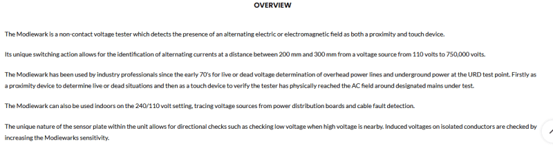

Voltage tester/sensors may be alright for medium voltages but can these be used for voltages 220kV and above?
That one says up to 750kV.
$299 doesn't seem like a lot of money to spend for safety.
