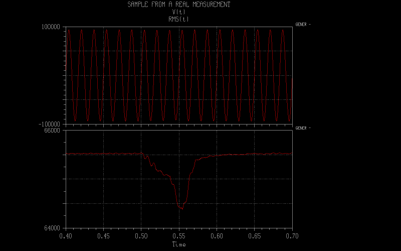

I am developing Gtpplot as an EMTP-ATP viewer. The program can read COMTRADE files, but I have not access to true COMTRADE files, I am retired since 1996.
Any example of such file are welcome, I can correct the reader using it as a reference.

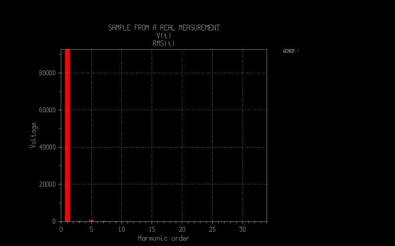

The signal has harmonics that are not an integer multiple of fundamental.
Any integer harmonic contributes to the RMS as a constant, but non integer harmonic produces the oscillations as your original graphic and similarly in Gtpplot

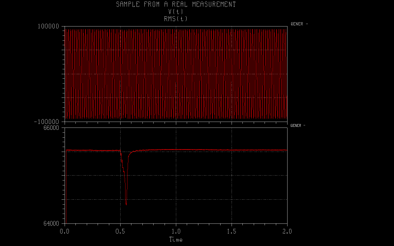

The file contains 100 points by cycle, corresponding to 6000 samples per second a Frequency=60 Hz
The Fourier components calculated by Gtpplot (using 100 points per cycle DFT, the speed is not a problem for off-line process)
Using a true sinusoidal source in EMTP-ATP, the curves are the same a naked eye, but the ATP RMS is a horizontal line.
By adding sources of 360 Hz and 420 Hz, the RMS show similar oscillations.
Thanks to your example I am doing corrections to Gtpplot.
