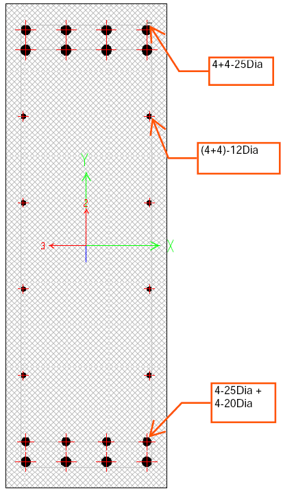

I have a two story RCC structure with multi bays in X direction and single bay in Y direction. The building LRFS is IMRF. Flexure demand on the beams in Y direction due to seismic loads is coming out to be very high such that some compression reinforcement will be required for -Mu. The span of beam is 10.5m
This is what the design forces at the support looks like.
Size of beam = 400x1200
Required +Mu = 1180 KN-m, As reqd = 2961 mm2, Provided: 4-25Dia + 4-20Dia
Required -Mu = 1680 KN-m, As reqd = 4861 mm2, As’ = 30 mm2, Required No, of bars = 12-25Dia
I cannot increase the size of beam due to clear height requirement (i.e., 5m) but also don’t want to provide maximum steel on the tension face of beam.
If I only provide 8-25Dia on tension face and take advantage of skin reinforcement and the steel present in the compression zone, numbers are showing me some decent increase in flexure capacity of the beam, due to compression force in the steel in compression zone (i.e., 4-25Dia + 4-20Dia).
I would like to ask for advice from experts here if they think this approach is workable.

That's a lot of steel in a small beam. Make sure the beam/column joint can physically be built. Sometimes the bar arrangement between the column verticals and the beam longitudinal bars is the limiting factor.
The only capacity increase you get is because the neutral axis depth is reduced so the C-T lever arm is increased.
The steel compression shown above looks high for the compression zone steel you have supplied. What strain has been used for the different layers of compression steel.
Presumably you have 4 25dia at the bottom at about 60mm from the compression face then 2 layers of 2 20dia as side face reinforcement. I doubt any of the side face reinforcement is actually in compression with a neutral axis depth of 186.1mm

...then 2 layers of 2 20dia as side face reinforcement. I doubt any of the side face reinforcement is actually in compression with a neutral axis depth of 186.1mm]
No, 4-20Dia are all near the bottom face. I actually didn't specify the side face reinforcement in the OP. I hope the following picture makes it clear. The results are ok. I've actually verified my manual calculation from sap2000.

With the bar arrangement as shown, 500 MPa steel and 30 MPa concrete I get phi.Mu values of 1945 kNm without the compression steel and 2039 kNm including it, which is less than a 5% increase. With higher strength concrete the difference is even less, because the neutral axis is almost on the level of the inner layer of compression steel. The difference from including the side face steel was much greater, but even with just the 8 25 mm tension bars I get 1791 kNm which is well over your required value. The required number of tension bars in the OP looks much too high.

Thank you so much for commenting. I performed the same exercise before posting here. I got the required phiMn when i considered both the side face reinforcement and reinforcement at compression face.

Most of the flexural strength improvement you're seeing will be from consideration of the side bars as tension reinforcement, not from the compression bars being considered.

OK, with those properties both the compression steel and the side face steel increase the design ultimate capacity by about 10%, or about 18% increase for the two combined.
I thought the tensile steel force shown in the output in the OP was for the tension face steel only, but if the side face steel is added in I get close to the same values using the 410 MPa yield stress.
I agree with Agent666 about the low concrete strength. I have never seen that low a strength used for a flexural member anywhere or any time over the last 50 years.
But getting back to the original question, yes if including the compression and side face steel increases the design capacity to the required level, then certainly it is OK to include it. In fact I include all the steel in my calculations as a matter of course anyway.
