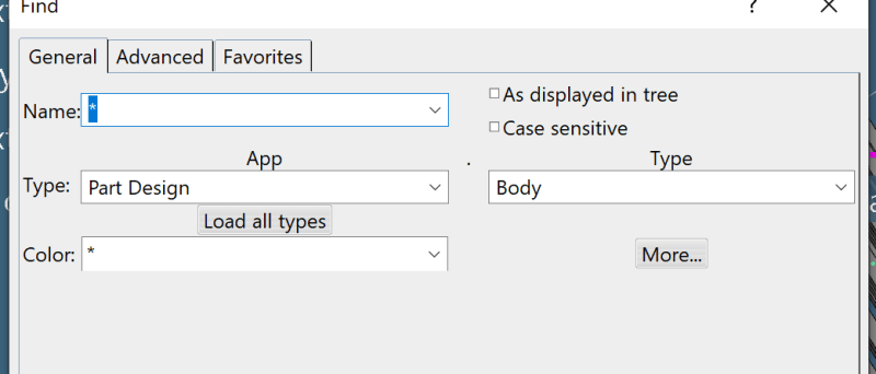

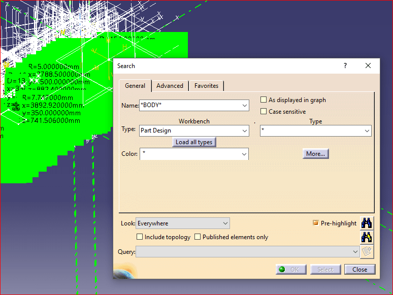

How could I unhide from the assembly only the solids (bodies)?
CAD 2015
search for Body then select and show
'Part Design'.Body,all

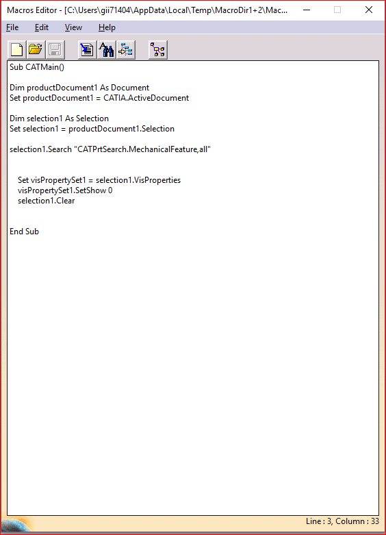

Something like this?
CAD 2015
Eric N.
Code:
Language="VBSCRIPT"
Sub CATMain()
Dim productDocument1 As Document
Set productDocument1 = CATIA.ActiveDocument
Dim selection1 As Selection
Set selection1 = productDocument1.Selection
selection1.Search "CATPrtSearch.MechanicalFeature,all"
    Set visPropertySet1 = selection1.VisProperties
    visPropertySet1.SetShow 0
    selection1.Clear
End Sub

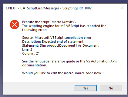

Ferdo,
It didn't work...…..:
Selecting "Yes", I got this message:
What was wrong?
CAD 2015
In the header of my code is written CATScript. What you have is a catvbs (pay attention when you open the editor in which kind of file you will create the macro).
To make it work in catvbs just put a "comment" in front of each As word.
That means
Code:
Language="VBSCRIPT"
Sub CATMain()
Dim productDocument1 'As Document
Dim selection1 'As Selection
    selection1.Clear
End Sub
