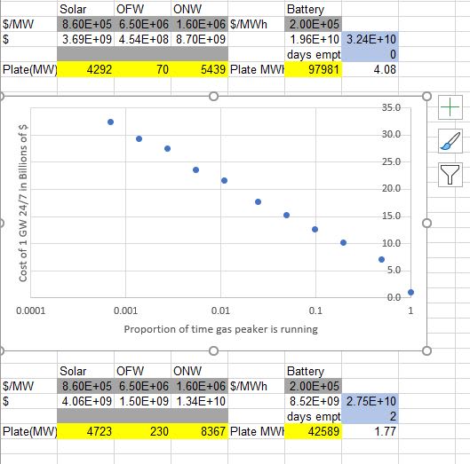

So here's what the UK is going to do. No fantasies about green hydrogen in vast caves. They are going to keep maintaining the gas turbines and use them as backup during dunkenflauts. So as predicted paying for two complete sets of generation and using only one at a time.

I think that's actually the best we can do if you read the whole article.
The power stations are already there so keeping them going is a relatively small cost. Most of the cost of gas fired per is errrr gas. Don't burn it you don't pay.
What else would you do?
I wonder how much energy it takes to start and shut down fossil fuel plants?
Gas turbines very little. The steam part takes a bit longer to get more efficiency, but the gas turbine part is very low.
Coal is much longer and did take some time but now the UK didn't have any. A quite remarkable change in my lifetime.
Well you may remember a little thread I put together called a simple challenge. And one outcome of that was the tradeoff between storage and gas. Basically you will always allow as much gas backup rather than storage as your hypocrisy/realism/cynicism/whatever about CO2 targets allows, because storage is so expensive. I may not have posted that graph, but I did explore the idea.

Here's the graph of cost for 1 GW continuous vs gas usage from that thread.
Glad to see the experts are catching on.
Cheers
Greg Locock
You should put this on a linear scale. I don't think the experts know how to read log scales.
...and to put the numbers in context Abu Dhabi's 5 GW nuclear plant came in at $30B, ie $6B/GW, with virtually no CO2 emitted. I particularly enjoy team stupid rabbiting on about this when you can just look at the cheese eating surrender monkeys, who have had cheap low CO2 generation for decades and are happily/profitably propping up the German greeny grid, helped by Poland's coal fired solution.
@TugboatEng hmm, I'm hoping we can wrestle system design out of the hands of the pollies and back into the hands of people who understand logs. As the Guardian article makes clear, it is happening, slowly, in the UK. Not yet in Australia, or California, or NY, or Germany, but maybe the UK's position as an islanded crash test dummy for Net Zero means they will have to actually work this stuff out. Australia will be next I think.

That's why peaker gas turbines are so expensive compared with baseload ones. As it is I think some storage is a good idea, so we aren't throttling the gas peakers every time someone switches the lights off.
