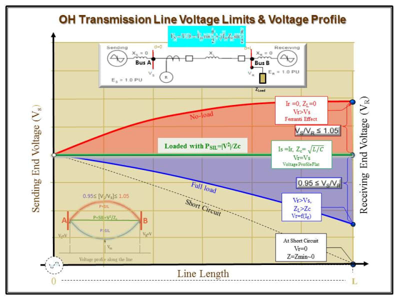

During a light loading condition, an overvoltage could happen at the receiving end of the line due to the Ferranti effect associated with the line distributed capacitance.
Since the equipment including insulators, circuit breakers and electrical apparatus typically are designed to operate up to 1.05 pu above the nominal system voltage, this value must be guaranty to maintain the system integrity.
There are a few options to keep the overvoltage under control. However, one of the most popular voltage regulation strategy is using shunt reactor compensation during light loading conditions. See the sketch below used as an Illustration of the possible voltage profile along an OH T. Line.
