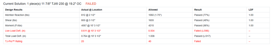

I was curious too so I plugged it in to Forte:
Not great...
Well, it is over L/360 but, yea, it is a crappy floor design
The problem in this case is that, technically speaking, the contractor didn't do anything "wrong." Yes, there's red stuff on that report, but that's only because user settings have Live Load Deflection limit set to L/480. It meets code minimum at L/360 and TJ-Pro Rating is not a code requirement. So while it may be an uncomfortable floor to walk on, it "meets code."
This is a good example of how we can express the value we add to a residential project. If you go by the minimum allowable, you get a "safe" and "reliable" building, but if you don't understand what that means and how the building works, it's not going to be comfortable.
