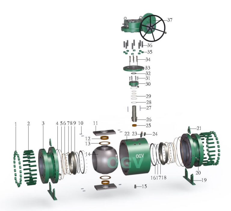

For butt welded valves I always ordered them to be furnished by the supplier with short pipe pups welded to each valve end butt. That way it keeps the field welders from cooking any critical valve parts, as they only work on the pup welds.
Buy good valves for high pressure work. Trunnion mounted. Don't want the stems bending in the high pressure making them difficult to open. Similar to this one. I do not know this particular company, but it looks like a rather good product. UK mfgr. There are others, but I'd suggest this type. You can usually specify the bore as "Reduced port", or by providing actual port diameter, if you don't want "full port".
Just saw the DN 15-40, so this might be overkill, but you can see where I was going in the don't short valve quality route. A lever actuator, if manual, should be fine.
Lots more here,
If you can tell us more, sizes, manual, motor actuated, emergency shut off service, criticality etc., maybe we can tell you more too.
