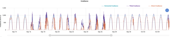

Basic plan is to build a very big solar farm in the Northern Territory of Australia, where land is cheap and sun is somewhat plentiful most of the year round, and then supply power to Darwin, and also to Singapore via a 4000 km long undersea cable.
Or
Basic plan is to get as much upfront taxpayer money from 3 governments into the developers pockets as possible
These two plans are not mutually exclusive.
Details
So, 1.75GW more or less to Singapore, 24/7, and 4 GW to Darwin (not necessarily 24/7). 20GW of panels, 40 GWh of storage. As you can see the numbers don't add up, 20 GW of panels might average 120 GWh of energy per day (i've got irradinace data for a few years from there, and I'll have a look in detail later on), but for days at a time there are monsoon related storms that kill the solar, and they've got less than a day's storage for Singapore never mind Darwin.
Data source for Tennant Creek Insolation https://nt-solar-resource.fulcrum3d.com/download I'll do more on this later but here's an illustration of multiday variability.
We aren't in the rainy season yet, even so some pretty lousy days. Incidentally the brief spikes are a fun phenomenon, on cloudy days when the sun appears through a gap in the clouds irradiance exceeds the expected value because the clouds reflect sunlight back down. Cute hey?
