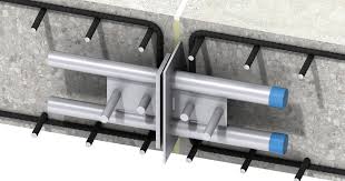

Came across a very strange condition on the lower level of a parking garage. Plank floor on what appears to be CIP beams.
An entire row of concrete beams down multiple bays appear to be spliced, or maybe not-so-spliced. There are clear cuts with no visible reinforcing spanning the gaps.
The locations of these cuts is equally weird. And it doesn't seem super intentional since you can see the stirrup exposed right at one of these locations.
Any thoughts at all here? Has anyone seen anything like this before? What the hell is holding these things up?

My opinion is , embedded shear connector with shear box or shear dowels ...The use of scarf joint ( in this case embedded ) is chosen to create a negative bending moment at the column and reduce the depth of the beam.
I do not think this is a recommended practice..
Pls have a look to the following doc , Heavy-duty shear dowels From Page 13 to see the concept . In this case , probably the shear connection designed with reinforcement only..

Obviously, whatever shear connection there is is out of sight. Perhaps something like these, as I suggested before.
Familiar enough with ancon connectors (the brand name is basically used as the generic term, bit annoying at times), just figure that they would be far easier to spot than whatever is going on in this thread lmao

The company says they are intended for shear connections of concrete beams, like the ones in your photos. And their web page gives a link to a design program, which I haven't used, and don't intend to do so.
The shear connectors are glorified dowels. You use them to carry a shear load across a movement joint. They provide the same function as a corbel; one side of a joint supports the other side.

Given the era I would guess you might find a Cazaly hanger buried in the middle of the beam. None of the modern connectors like Tom shows existed then, so they would build them in their own shop.
Cazaly hanger makes sense, as there doesn’t appear to be any shear connection in the beam web.
