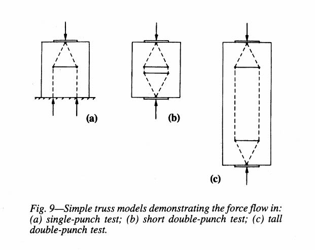

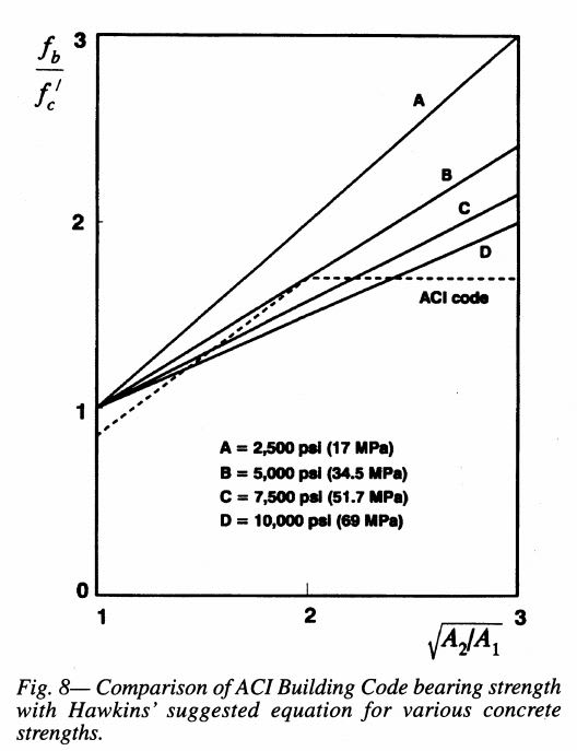

My strict interpretation of the ACI provisions as written would be the lesser of these four checks.
But the story gets a little murkier the further one digs.
1) First expression below is what Hawkins originally proposed. It's a function of the concrete tensile strength as one would expect.
2) The ACI simplification of Hawkins' equation winds up being less conservative than Hawkins' equation above about 5ksi.

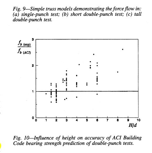

3) The Hawkins testing was done an a single punch model as shown below. On a long, double punch model the results are about the same. However, on a short, double punch model, the results worsen some because the lateral bursting effect from both the top and bottom loads kind of aggregates in one spot. This short, double punch model would actually seem to be the closest analog to OP's condition.
4) Rationally, if you're a short, double punch model but you can push on a bunch of neighboring concrete for confinement in addition to just relying on concrete tensile stress, I'd have to think that you'd be in fairly excellent shape. That, particularly given that there's probably an concentration of slab rebar in this area too. This might be a justifiable reason to throw some of it in the bottom of the drop panel.
