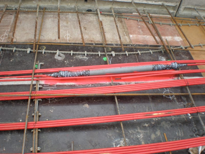

In-situ they are installed as per this typical photo:
Typically from 2 to 5 in a flat bundle for slabs, and often 7 in a bunched-up bundle in beams.

Out of curiosity, what is the grey pipe looking thing? Is that a cable-joint? And if so are they common? Reason I ask is the principle of travelling wave reflections is that you will get a reflection back from each step-change in impedance (akin to each physical change), so you will get a 'false positive' for things like cable joints.
The grey pipe is indeed a splice. These are not very common, and occur when the strand is accidentally damaged (cut wires etc) during construction and they place a splice chuck inside a greased PVC tube and seal. For such a case we would NOT be proposing this TDR method to determine any cable length measurements.
Just curious, would an oscilloscope be able to pick up splice location/s such as that in the photo above? I would guess it would show up as a bump on the scope, so may be able to back calculate the approx position of the splice.
