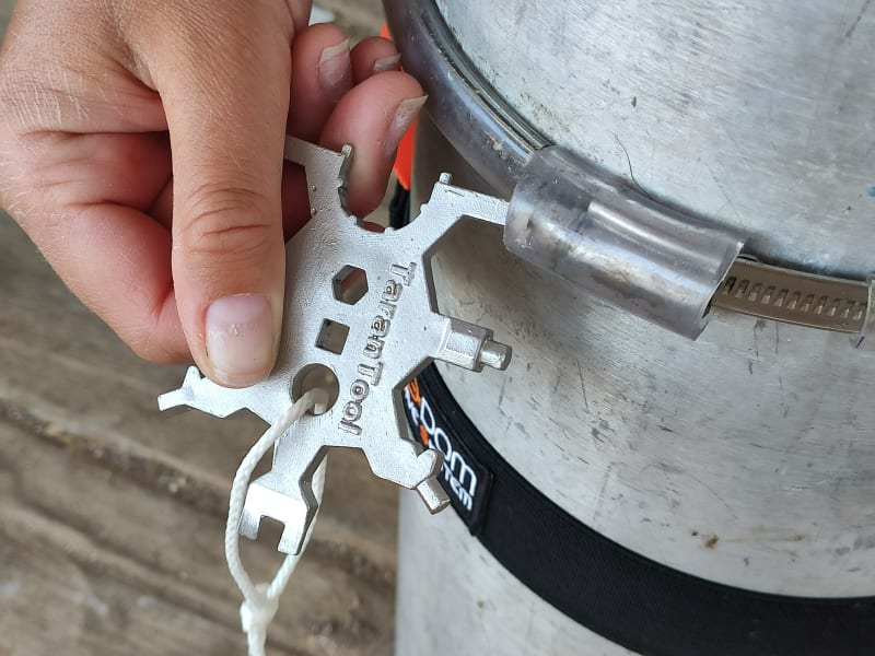

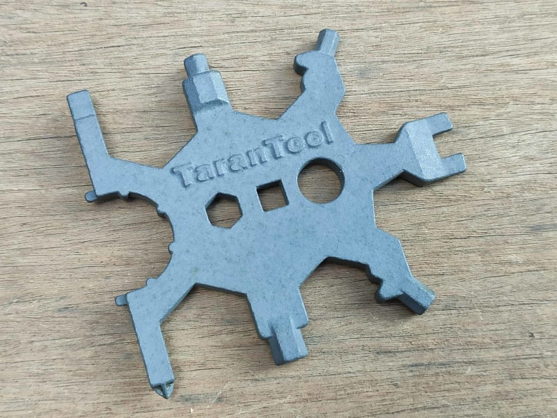

Hi, I have designed and produced (outsourcing)a tool for diving.
Till now we have made it from lost wax molded SS17400PH hardened to HRC42.
A new manufacturer suggested me to use MIM and S420 2.0 with a hardness of HRC46-54.
There is a flat driver on this tool that is bending when using lots of force and is the weakest point of the tool.
I have thickened it and widened it for the next tool design.
What are your thoughts? Suggestions, anything I should beware of or think of? etc...
Thanks in advance for your answers.

The tools is not always rinsed as it sits in a case or pouch. That is not my concern as it will is treated with ArmorGalv process.
As for bending vs. breaking is more of my concern. Today it bends when using excessive torque and I have thickened it from 1.8mm to 2.2 and widened it from 4.6 to 6mm.
Is 420 at HRC50-54 more breakable or will also first bend, compared to s17400? it is not nice for the client to bend it but better than break it. But best is if it will hold more than the force of the hand power when used.
Till now I made 1000 pcs with lost wax and it was the best cost /unit ratio. But thinking of more nice finish and precision of small details and 3-5000pcs at least, I thought MIM would be better?
Flat driver on top left.
I would have put the two screwdrivers in the middle positions and the hex drives on the end.
A flat blade screwdriver on the end makes alignment difficult and lets you apply more torque, neither of which are good.
And the hex drives will handle more torque.
Thanks Ed for the advice. The way it is designed is with thoughts of how it is used. Having the flat in the middle wouldn't work as it touches something.
Every mm is with usage thinking.
My hesitancy about this is seeing that screwdriver blade only partially engaged in the slot and then twisted hard and breaking off a part of the blade tip. This thin portion of the blade may not need to be as long as it is, keeping it shorter would help strengthen it.

With a slotted screw head the things touching most frequently will be your knuckles on metal.
But if you insist on having it, put it in the middle position but have it stick out farther than its neighbours.
This is how it is used. But as I said it will be thickened and widened on the next production.

Till now I used s17-4PH A900 but as said, the flat driver bends with excessive torque. Thickening it might be enough. I'm not sure the current manufacturer is using S420 2.0 material and therefore I asked. If he don't I'll have to decide whether to continue with S17-4HP or look for another manufacturer that uses S420 2.0.
Also at current molding costs, MIM vs. Lost wax @ 1000 pcs as the first production batch, looks like the lost wax method is winning.
The only q. is S420 2.0 or S17400. I'll ask the manufacturer. If they do both I could have both tested and decide. If not. We'll see.
