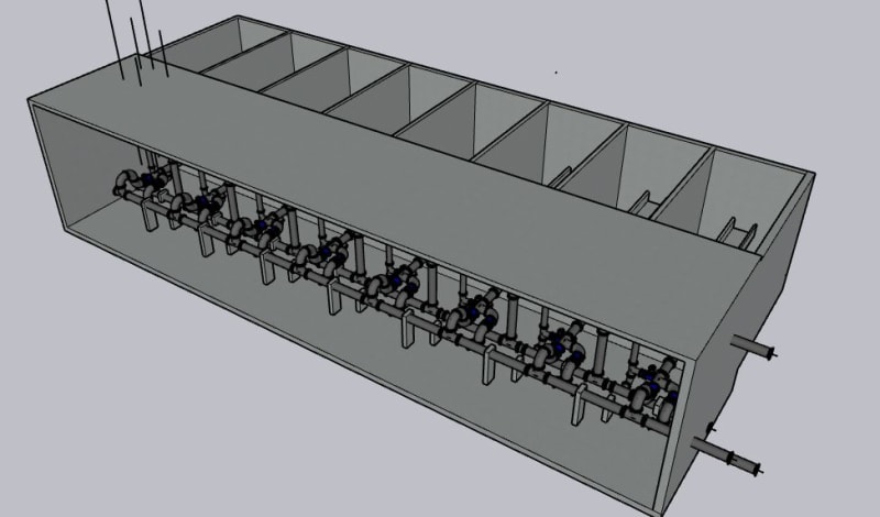

I have a 30mx13m Rapid Sand filter and a valve room (part of a water treatment plant) as indicated on the image below.
[URL unfurl="true"]https://res.cloudinary.com/engineering-com/image/upload/v1666258926/tips/RSF-3D_yxwb3k.bmp[/url]

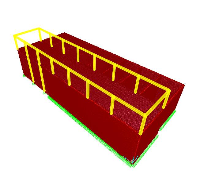

I have modelled the entire structure as 3D on gmsh (a meshing software) meshed the shells there and imported to sap2000 and added the columns at a joint for analysis. But one side of all columns and the wall supporting the interior column are all supported on 1.4m Long RC slab. I know it is not ideal to support it that way and that wall resting on the 1.4m slab should have to extend all the way to the foundation but it is near impossible because there are pipes and pipe fittings and a lot of valves. So, I had to see if I can support it this way. But I was expecting the negative top moment at that overhang slab to be relatively large but I am not getting the results I'm expecting. So, just to see some conservative result, I took the 1.4m long overhang slab as a 0.3m deep by 1m strip beam and modelled it with the right side fixed.

The result resembles what I'm expecting. Maximum support moment is around 144KN.m (about Φ20 @ 140mm)
For comparison, The result from the full 3D FEA analysis is only about 50kN.m for the top support moment on the overhang slab (around
Φ12 @ 170mm )
So is this acceptable why is there so much difference I know the 3D anlysis had to distribute to all members and had to be a little bit lower but is the difference not huge?
I suspect the reason to be that there is no "overhang beam" (cantilever) in the structure. It seems connected to two walls in the figure you provide and is thus part of a building frame, which will obviously cause different bending moment distribution than a cantilever.
@centondollar I think you are right, also the deflection at the left cantilever(ish) slab is too small (close to fixed support) further justifying your answer. And now that i think about it, 144kN.m/m seems a little exaggerated too. But, I'm still not convinced as the 50kN.m/m from the 3D FEA analysis feels a bit too small and risky. But again I could be wrong.

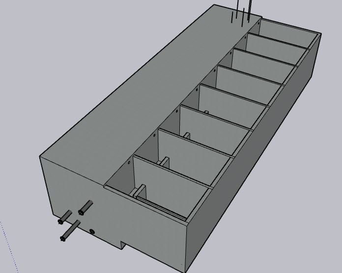

@HTURKAK Thank you for your answer, The sand filter is composed of 8 compartments (units) each 3.6m wide. sorry for not attaching the plan earlier(I thought the compartments are visible on the 3D model I shared before)The internal partition walls look like the following image.
The filter material which is basically 0.85m sand (unit weight 19kN/m3 and active earth pressure constant ka = 0.27) and 0.6m deep gravel (unit weight 16kN/m3 and ka = 0.27)

Apparently, the latest isometric pic. shows that the subject wall is supported by partition walls rather than cantilever slab ..and the 3D FEA analysis ( 50kN.m ) seems correct..
This assumtion is true for normal operation.. during back washing, totally different..
