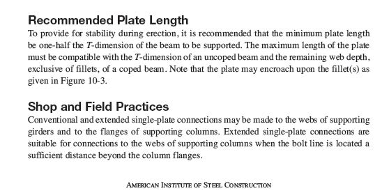

I'm not sure where it is at in the steel manual, but I know AISC recommends that your connection plate is at least 1/2 of the 'T' dimension shown in Table 1-1 for all the sections...
They also address the maximum size of a connecting plate and 'riding the fillet'.
I found it. This snip is from page 10-106 of the 14th edition.
They do recommend a length, but their recommendation is for stability during erection. I suppose you could deviate from that if you had a good reason.
