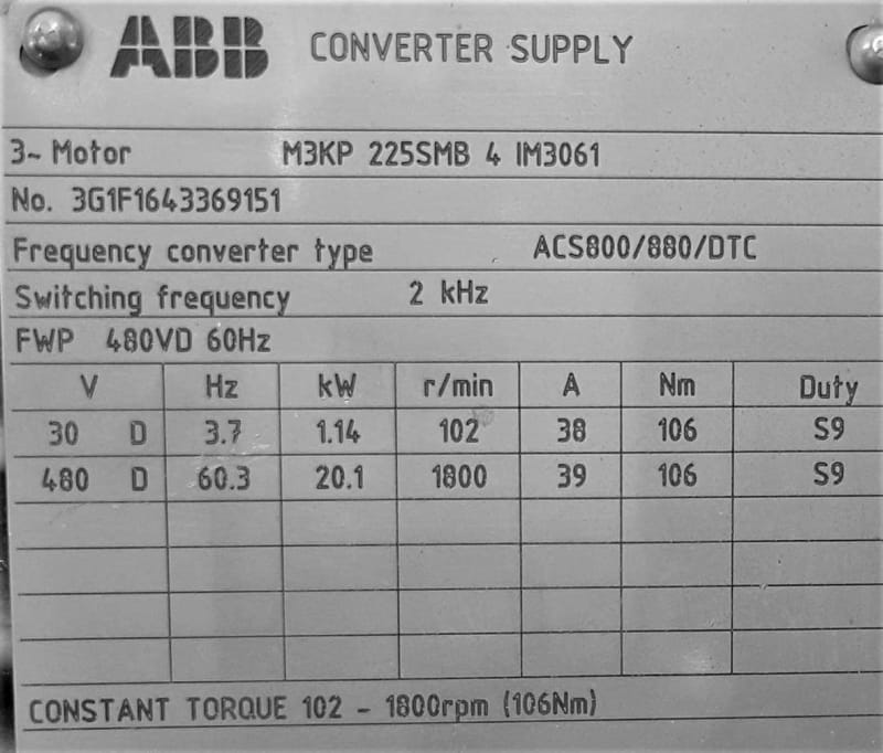

If you return back to the ABB converter performance data shared above, you will see that the drive and the motor can deliver constant torque 106Nm at speeds range from 102-1800rpm at about 39A output current.
So, for the drive (at Normal Duty) which can supply continuous 52A output current at full speed to the motor (FLA: 49.3A), can we say it can handle the torque required to withstand the shock load and the speed drop ?
I think the problem in my current configuration that it is set for variable torque and speed regulation, so if the motor reaches full speed the torque required to keep the motor at full speed is lower than that required for acceleration, and in return the output current is reduced to adapt for the lower torque requirement.
So, may be what we need is to configure the drive for torque control (Constant Torque) in Flux Vector mode instead of speed regulation, Danfoss says "Sensorless Flux Vector" can handle shock load better than other control modes (like VVC, SV, V/Hz).
I will try the above configuration and see if it can make difference.
If that nameplate is from the motor, then that is a 20kW motor, which makes it a 25HP, not 30kW (40HP) as you said in the first post. So if that is indeed what you have, then that drive is fine, it is a 30HP (22kW) Constant Torque rated drive.
But yes, the DEFAULT setting for the drive will be Normal Duty which provides a variable torque output curve, so you would have to change it to a Constant Torque output. So on a PowerFlex 753, you would change Parameter 306 from a zero to a 1.
You also have the option for Sensorless Vector Control (SVC) or, if you like, "Encoderless Flux Vector Control", which is similar but more ACCURATE in terms of providing torque more quickly, but does not provide MORE torque. By quickly, I mean that the response to a step change in load is going to be in a few radians as opposed to a few revolutions. In a high inertia load such as yours, that likely will make little difference. If you want to experiment with it though, P35 is where you change the control mode. If you want to try Encoderless FV mode, you set P35 to Induction FV mode, then you don't give it an encoder feedback. But you must pay attention to other factors, such as the gain on the feedback loop, compensation for cable capacitance etc. In addition, you will want to do a ROTATING autotune, not just the simple static one that you can use for SVC.
"Torque Control" is for when you want torque to be constant regardless of speed, like in a wider application where the speed is constantly changing because of changing diameters of the load, but you don't want too much or too little torque because you don't want to tear the material. That is NOT what you want here, because you have already established that a change in speed is undesirable. Leave it in Velocity mode.
I would likely try drive for torque control (Constant Torque) in Flux Vector mode also. Changing drive parameters is hugely less expensive than changing hardware. Flux vector + encoder feedback might improve performance a bit, but as the application does not need precision and requires adding the encoder, I would try this after other options.
