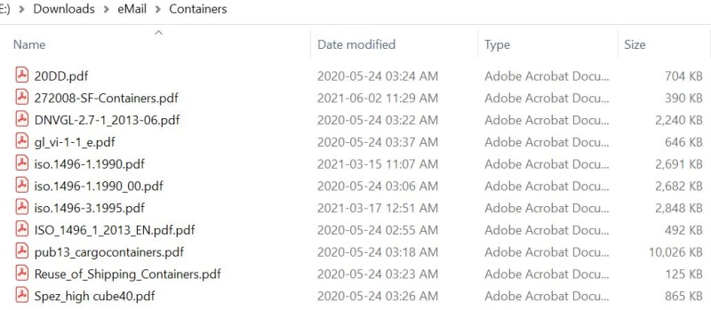

I have several articles on containers from a project a few months back... this has some fittings as well as bunch of other stuff.
 https://files.engineering.com/getfile.aspx?folder=aac27e46-0d0d-4ee7-bf27-b56ed97b1597&file=pub13_cargocontainers.pdf
Directory snapshot...

Dik, I was going to say that I have a bunch of shipping container standards, and that it wasn't really what I was talking about, but I looked in there and there are definitely details for the locking mechanisms. I don't think it'll really help me, because I'm in situations where I'm doing one offs and manufacturing my own locking assemblies won't be cost effective over just welding something on, but it's good to know if ever want to do something at scale. Looking at your directory, have you also run across the ICC document about shipping containers as buildings? It's helpful in some areas and a good thing to point at as definitive when doing engineering on them: "ICC G5-2019." Just something you might want to add to the library if it ever comes up.

I've come across a couple of container for buildings articles; I'll check and update the directory as I find info.
