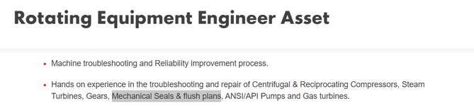

What is the significance of Shell recruitment requiring skills in Mechanical Seals & flush plans ?
Usually done to seal vendor specifications and maybe sometimes attended by Shell staff.

I would think that part of it is that you'd get the seals and flush plan background from the other requirements (compressors, steam, etc.). Also remember that a lot of what that company does qualifies under hazardous environment conditions - which means things can get a lot worse in a hurry, compared to a typical industrial facility with water or slurry pumps and air-handling equipment.
"and maybe sometimes attended by Shell staff."
Hence why they want someone that knows what they re looking at and whether it is being done correctly or not.
