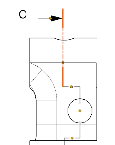

When editing a stepped section line, it can be very hard to find the selection point on the line segment.
Is there a way to change the point size, or any other setting, to make the point on the section line segment easier to see ?

I'm not sure if this applies to the selection points on section lines, but in visualization preferences -> color -> handles, you can change the handle/point size.

Increasing the size under "Handles" does not affect the selection points on the section line.

Not sure if it works anymore, but the old trick used to be to crank up the calibration size. This would result in the onscreen representation being larger than the actual item when the view zoom was set to 1.0. This had a side effect where all the temporary geometry (splats, arrowheads, etc) appear larger onscreen. This option is found in visualization preferences -> calibration. I've never tried it myself, YMMV.

Jerry, Can you post an image on this ?
in our setup these points are "load and clear"
Edit :This is NX1980 / "2000".
