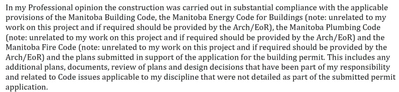

The City of Winnipeg requires 'strict' certification on engineering stuff. They have a prescribed letter of approval. My certification has a few additions:
That last sentence is a major YUCK. "aLL THE STUFF i DON'T KNOW ANYTHING ABOUT IS FINE."
you betcha, but they won't accept anything less. To make matters worse, the professional association has endorsed this. It should be a requirement that anyone working with the association have at least 15 or 20 years of real world experience.
They might change their tune if all of the engineers just stopped working in Winnipeg.

pham... the problem is that the association puts up with this.
