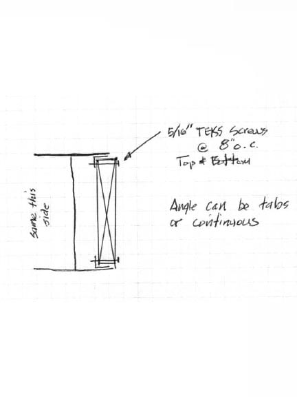

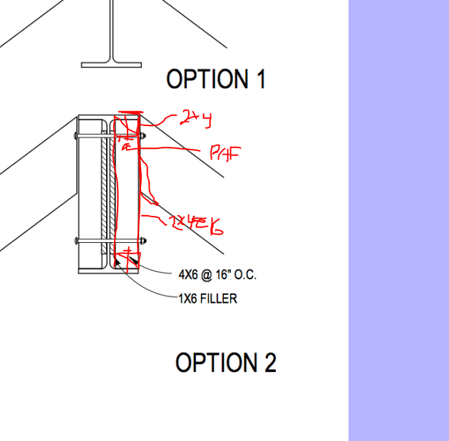

I am designing a garage for a customer with a 46 ft. span structural ridge. Gonna use a W24x76. Looks like it will take a small forest to pack this thing out with 2x12’s for the rafter attachment (Option 1). Was also thinking about bolting a vertical 4x6 to the web at each rafter location instead of using continuous packing and using a hanger. (Option 2).
Seems option 2 would also be more amenable for sheetrocking
What are y’all’s thoughts? Any better ideas out there?
