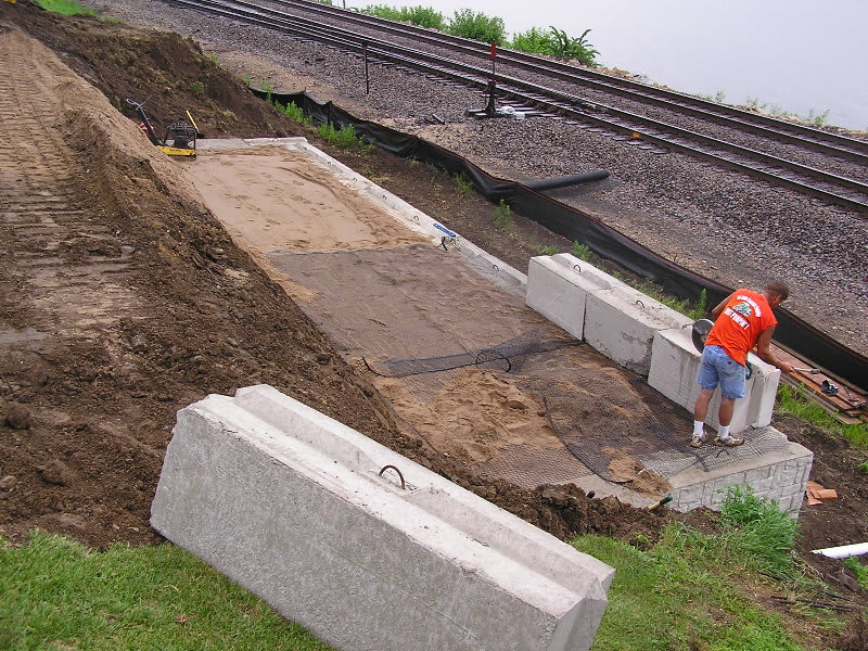

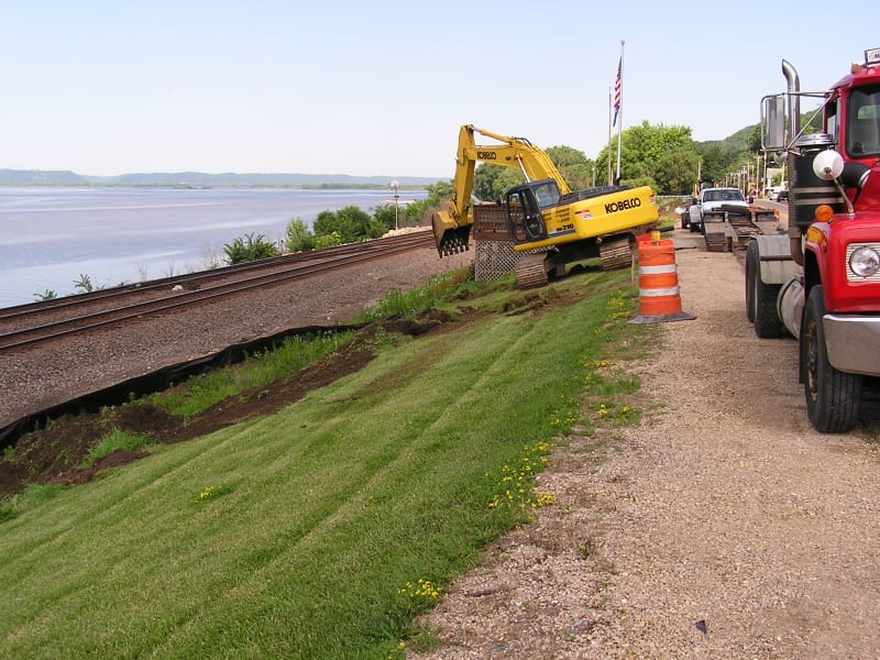

I did a volunteer engineering job for the Village of Ferryville, WI. There was a right of way street dedicated out into the flats of the Mississippi. Job is about 40 miles south of La Crosse, WI. the village wanted a park between the main highway and the railroad. They applied for grant money from two agencies and got 80 percent of the job estimate, based on using blocks of concrete, left over from ready-mix trucks and reinforcing with plastic grids. I was to get the 20 percent for engineering, etc. This right of way crossed the right of way for a busy railroad., but the only limit in going close to the tracks was something like 17 feet from nearest rail. That is the limit for typical bridges over the tracks.
Anyhow, the job was bid and the use of those reject concrete blocks got it. I checked the supply of blocks and found them very sound with the tests by an impact hammer test. I have many photos of the progress sand wonder how about 10 of them might be sent to you.

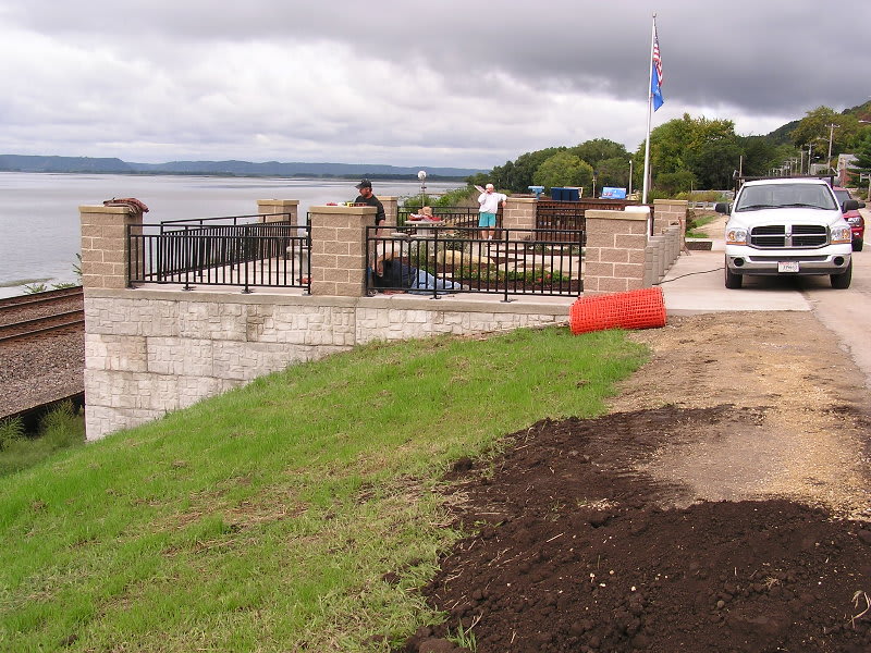

I am attaching a shot of the completed job. By the way, to make the 20 percent engineering legal with the grant money, they paid me by check. I endorsed that v check back to the villeinage's park fund.
I could send the photos this way, maybe a few with each reply. You decide. This is before the job.
Here is the final job. The guy in shorts is my neighbor, a retired insurance guy, he was the rodman.
I see by the photo, the set-back of the job from theail was much larger. then my guess.
