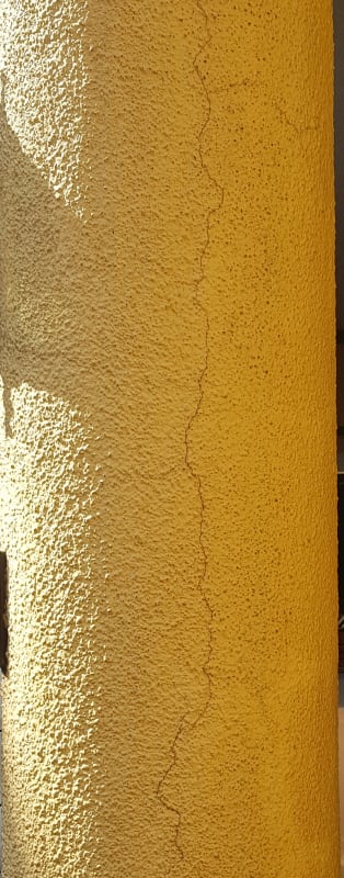

This round column measuring 12 inches diameter (0.3 meter) has 8 pcs of 20mm rebar with 10mm spiral ties spaced 8 inches (0.20 meter) apart.
There is a vertical hairline cracks measuring about 1 meter. I'd like to know the following:
1. Usually what caused the vertical hairline crack?
2. Can the rebar inside rust if nothing is done to them?
3. Should carbon fiber be wrapped around it?
Suspect temperature effects, expansion and shrinkage. Appears to have differential exposure to elements.

Are you sure it's not just a crack in the applied render?
I don't want to chip the render or concrete as the whole column is only 1 foot diameter. Here is zoom of it. It doesn't look like just the render because the crack is discontinuous so unlikely.

Carbon fibre is only generally used when you have a confinement issue not as a crack repair strategy. Like others have said, to repair and address the root cause you probably need to investigate what is going on, and if it turns out to be a durability issue establish if it is a carbonation issue, chloride ion ingress issue, some issue with the orginal workmanship, etc. If its just a crack with no underlying issue, then getting it injected is pretty easy, followed up by tidying up the render.
All concrete cracks (due to shrinkage/flexure), if the cracks are within the bounds of what is allowed considering durability provisions within your code of choice, then there is nothing to probably worry about unless you have signs of spalling that might indicate a corrosion issue.
The column shown is obviously not as-cast and has some sort of stucco-like coating. What is the coating? If it is a brittle cementitious or acrylic material the crack may just be in the coating material. Best you try to confirm that the crack is indeed in the underlying concrete.

The column is coated in plaster. trying to diagnose a problem with the column behind is even more of a guessing game than identifying structural problems from the inside of a building via a crack in drywall. you need to clear away the plaster to really know whats happening.
My guess-timation is that the plaster coated column experiences regular wetting and drying on the external face, regular sun & associated temperature variations on the external face. The inside face is sheltered. These repeated weatherings has cause movement, which is why there is a vertical crack along the line between exposed and sheltered plaster.
I wouldnt give any opinion without tearing a good portion of the plaster off of the post.

We chipped off the surface, the crack is in the concrete and not the coating. See:
It is NOT even 1mm wide, just paper thin hairline crack.. how do you inject epoxy resin in paper thin gap? If not possible, how do you fix it?

Keep chipping...you have NOT determined the cause.
Crack injection of concrete cracks as fine as 0.005" (0.1 mm) are possible with the right plural-component pumps and low-viscosity resins.
