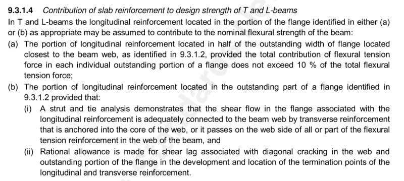

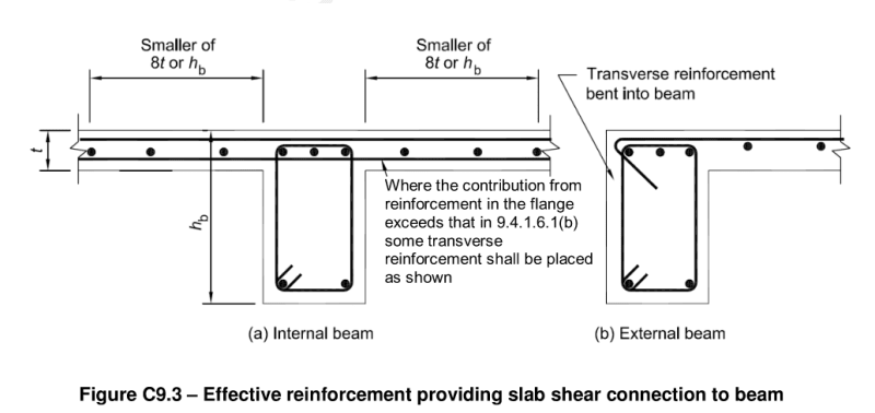

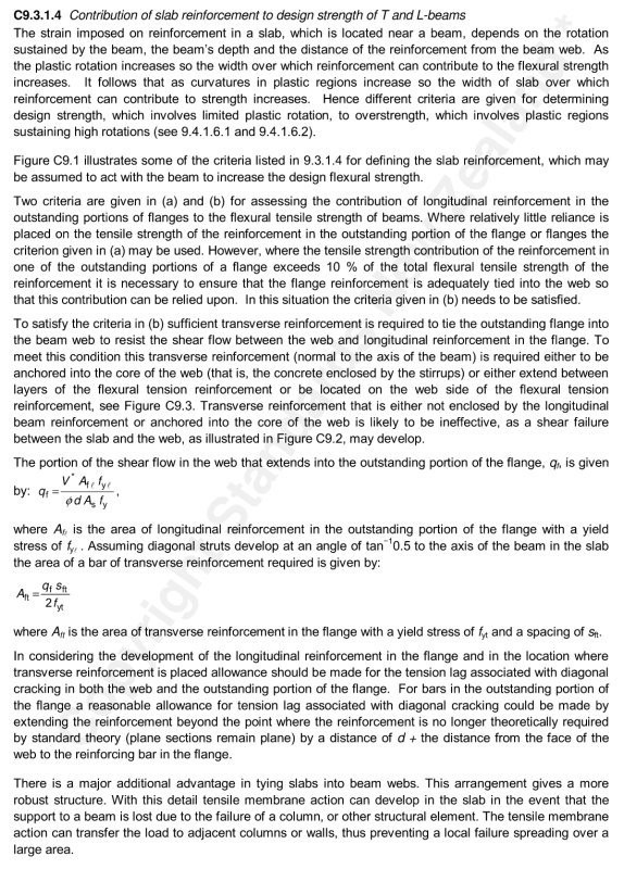

Our NZ code only allows 10% of the reinforcement in the beam to be relied upon in the slab, unless you do a strut and tie to ensure you can utilise reinforcement placed in the slab, (for example this basically means you need the same reinforcement going orthogonal to the beam to support a strut and tie model with 45-degree struts). The code allows a slightly more favourable angle to be utilised, but you get the idea. This seems far more logical than simply stating all of the reinforcement within the effective width can be utilised. Relevant clauses below for your comparison:-
Code Clause (note 9.3.1.2 referred to gives the calculations for the effective widths in compression)
Commentary clause

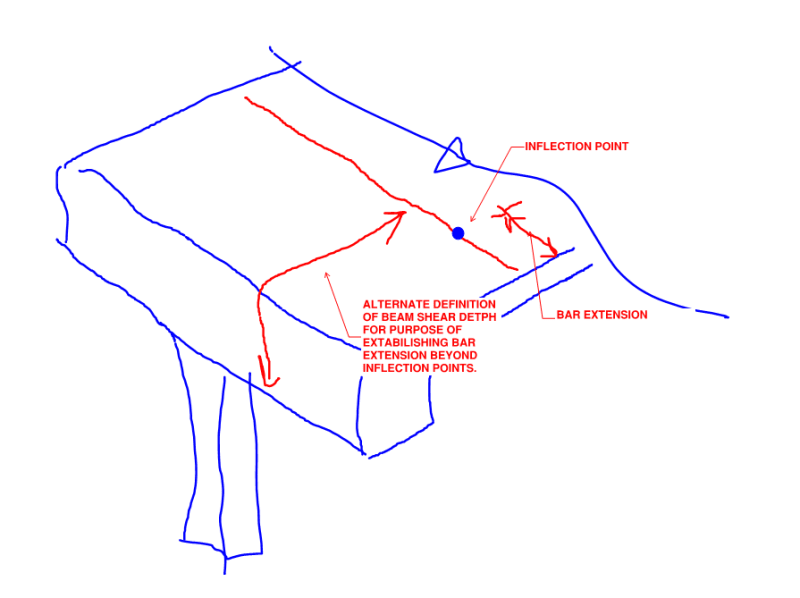

My local code seems to handle this less rigorously than others. The sketch shown below is what I've done myself in the past. In essence, it's a poor man's version of the strut and tie approach that Agent666 recommended. Even at that, I try not to get too carried away with the effective width and try to keep it within 25% of the beam span. That's usually pretty easy to do, at least in new construction.
