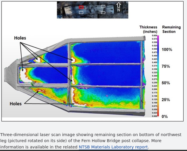

More like No one looked at or did anything about the recommendations from the inspection reports for 10 years....
So presumably this weathering steel doesn't like being submerged in water / kept constantly damp or with quite anaerobic conditions?
How is it unfair? I didn't fault the inspection, but rather the maintenance... which follows inspection. You are correct about weathering steel. And a big part of the lack of maintenance, also probably the design, was failure to ensure adequate drainage.
Yup, Corten needs wet/dry cycles to prevent ongoing corrosion. It is the same reason why Corten is not a good choice in high chloride environments. The salt keeps the surface continuously damp and corrosion keeps getting deeper.

However, as with any other steel, failure to properly maintain uncoated weathering steel can lead to corrosion damage,deterioration, and section loss in critical components, thus reducing the safety and service life of the bridge.

Blaming weathering steel is a bit silly. This was a steel K-frame bridge and the web of some of the legs was so rusted out there were holes in it. That kind of damage doesn't happen overnight and was noted on the inspection reports. What kind of owner turns a blind eye to that?
