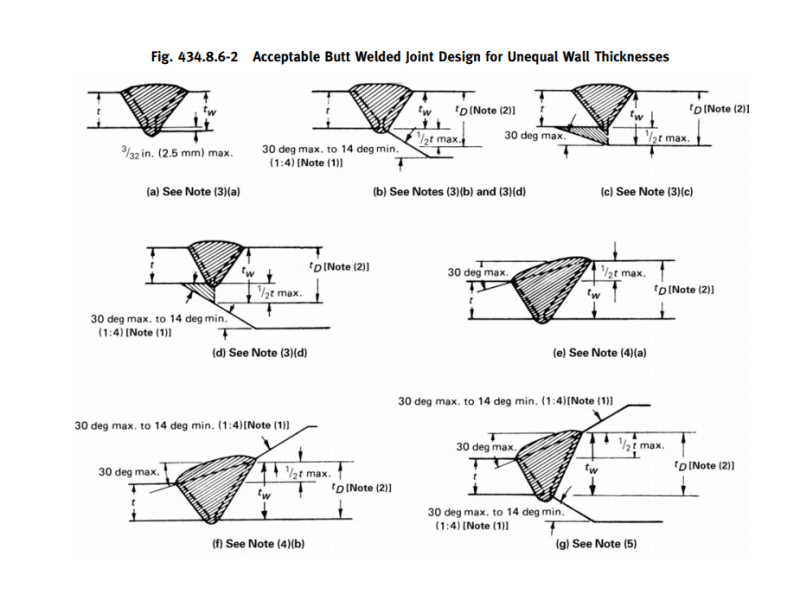

I know ASME B31.4/31.8 and CSA Z662 clearly define the requirements for a transition piece based on the WT Change between the existing pipe and the new pipe.
Is there a Canadian or US Code/Specification for Oil/Liquid system that defines the requirement for a transition piece if there is minimal WT difference, but a large grade/SMYS difference between the two pipes, Eg: Grade X56 to Grade B is a 21 KSI difference, but the WT difference is less than 1.6mm. Would a Transition piece be required here?

If the lower smys pipe is still OK at the thinner wall thickness then you don't need one.
If it isn't then you do.
But look at the code for an acceptable inner misalignment. You might be in luck.
Welding is somewhat easier if there is no more than a 10ksi difference.
However it is left to qualifying your welding procedure.

Then not sure why your higher grade pipe is a thick as it is.....

The difference less than 1.6mm is not a problem. The transition is in the weld.

The code example below is B31.4, but think 31.8 is the same. So an internal mismatch of <2.5mm is OK - see a) below.
But I echo Mr 44 - The advantage of higher SMYS is a thinner pipe for the same pressure and temp, but you don't have this for some reason??
