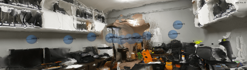

Update: I found a free tool called Marzipano that lets me make simple 3D tours like this:
My office is being renovated, so I documented it with a rented Ricoh Theta Z1, which is in the picture above. I can look and step around the office. This tool has no measurements; just viewing.
I created a point cloud in 3D using a free trial of Agisoft Metashape. I was able to do some measurements, but it's so rough that it's completely unusable.
The camera I used costs about $1200. To get a nice, usable 3D scan with Lidar, I'd have to spend $25k+ on a Leica device like a BLK360 and ~$3800 for one copy of Metashape (software), or use a monthly fee cloud service with limitations, which will cost more than Metashape in the long term. To view and measure it, I can use Autodesk Recap free version or Blender, which is fine, or Metashape (not great for viewing). But to have a 3D tour with measurements, I'd have to spend at least $10/month, but more likely $50/month or more for the scale of things I'd want to do with it.
All of that is to say: I'm happy with the workflow of a cheap 360 camera and free software just for viewing. Taking the photos was extremely quick, like a few minutes to document the whole office, and gives a lot more usability than 2D photos. It will help with site visits. Only thing I need to figure out is how to use flash with this arrangement.
Adding measurements into that is a significant cost, on the order of a cheap Lexus. It's something I'll revisit in the future when I scale up. For reference, we have 7 people at the moment, and it's not a good business decision for now. Tape and laser measures will have to suffice.
Drawings: This will be far, far down the road. But from all the research I've done so far, and messing around in the software, it's not feasible to make floor plans with 3D photogrammetry. I think the best it can offer at the moment is a second background to align with Revit, and that will cost a lot. It's not necessary for what I do. That being said, there are paid services that do it, to make floor plans and stuff. I have a feeling that they outsource the 3D models to India or China and have someone trace it.
iPhone with scanning software: I tested it around the office and it gets better results than the 360 camera for measurements, and doesn't do 360 photos. It's fairly usable. I have yet to try it at a jobsite. But to make this work with employees, I'd have to buy an iPhone for the office just to do this, which is kind of weird. Most of them use Androids, and even if they don't, it's not right to ask them to use their own device for work.
Panoramic photos with 2D camera: Not feasible. Takes wayyy too long compared to a 360 camera. Will slow down job site documentation.
