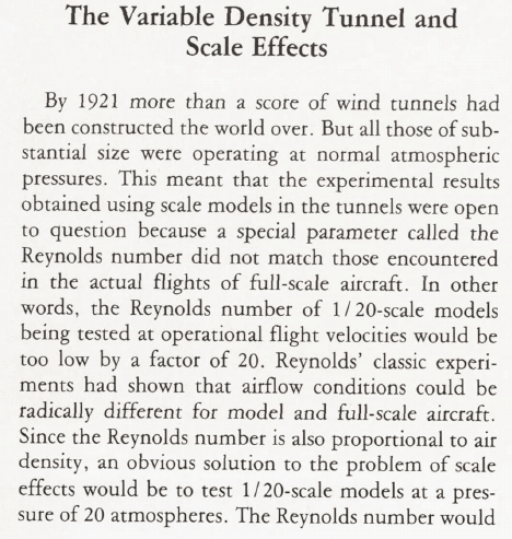

I seem to recall that with scaling, the Reynolds' number doesn't scale well... This was from 60 year old work in hydrology...

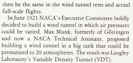

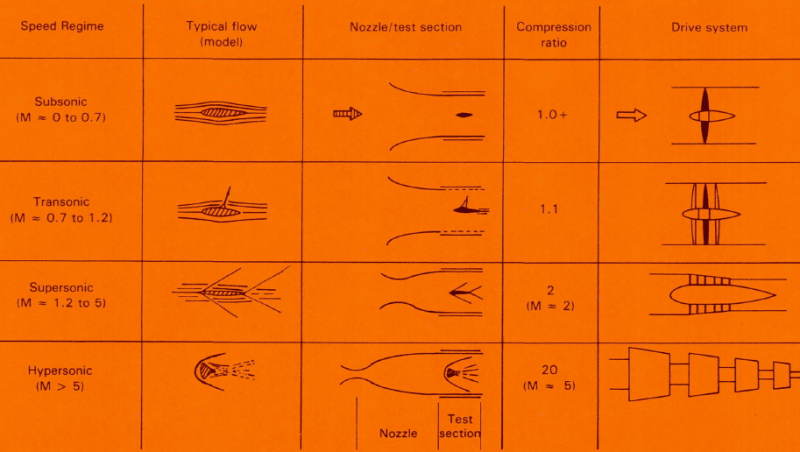

"the Reynolds' number doesn't scale well..."
This is true. However the main reason for concern on Reynold's number is the prediction of the onset of turbulence. A main driver of the Reynolds' number is density, which is why incompressible regime testing can use tiny models of aircraft in water tunnels where the effects of density offset the change in the ratio of dynamic effects to viscosity effects.
I don't recall compressibility effects being much affected by Reynold's number but it's been a while since that was on a test. Compressibility is very driven by gamma and dynamic effects.
This document provides some of the history of the origin and use of variable density wind tunnels. Sorry the citation is too big to upload.
