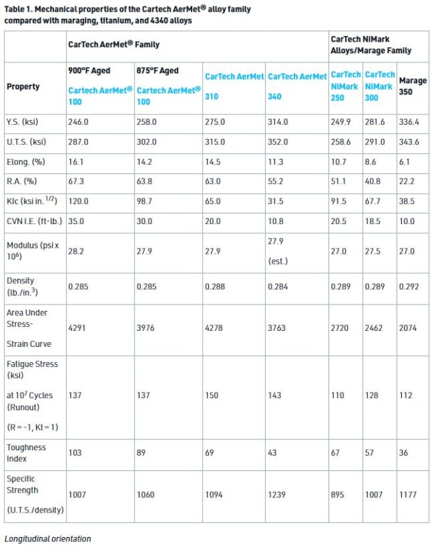

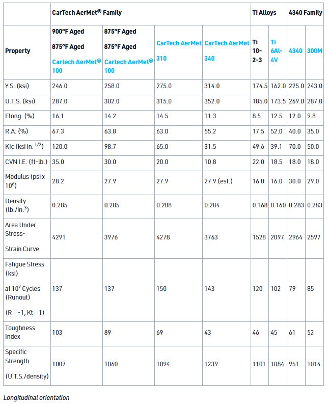

What would be the most important material property to achieve this? We are looking at Aermet 100, Ferrium C61, MP35N... Seems 300M is recommended for shafts frequently on here.

Compare all the stats. Hardness, tensile yield and ultimate. Charpy properties.

So, focus on material fatigue strength at 1E4 cycles?
C350 has a relatively low fatigue life - 110 ksi @ 1E7 cycles I believe.

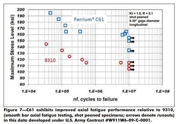

Based on SN curves, Ferrium C61 and S54 look like they're almost as good as it gets.
I found this previously, thought it was a nice toughness comparison of high strength materials:

Ferrium C61 looks very nice from a fatigue standpoint:
