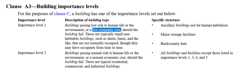

I have reviewed the B1 and am fairly comfortable with my definitions for sheds and farm sheds.
Imp 2 - anything over 150m2 is imp2 for economic reasons - this would equate to roughly $60,000 for the structure excluding foundations.
Does anyone have some good definitions for farm/industrial sheds with low occupancy gernally below 3-4 people?

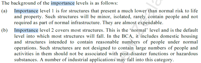

ASNZS 1170.0 supplement 12002 seems quite clear
Owners can of course ask for a higher level of design actions.
I would suggest that if you can show or state that the structure is minor, isolated, rarely contains people and is not required as part of normal infrastructure that it qualifies as an imp1 structure. It should be easy to do.

NZ has a code which deals with importance level which should be governing over anything in the AS/NZS standards, if we ha to abide by the building code, some structures do not.
In this par of the code it does have a low economic cost requirement. the give examples of barns, sheds and ancillary buildings, however no size limitation. For me a 150sqm shed would be a large economic impact.
Who made the wording in Clause A3? Should be 'and' not 'or'.
I wouldn't think the low economic cost should enter into the criteria.

In 20 odd years of NZ design the only structure I've ever designed as IL1 was a fence. I think it is quite clear in the code the intent, it is as per the examples posted in your second post rowingengineer. Do you fit into one of these examples (ancillary building not for human habitation, minor storage facility (garden shed, farm storage, etc), backcountry hut).
