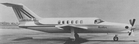

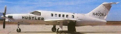

For Giggles.... Here was an arrangement vetted in the 1970s. There was a turbo-prop hung on the nose... and a small 'fanjet-engine' for take-off/heavy in the fuselage tail-cone... supposedly for twin-engine safety and extra power for take-off and heavy-weight climb. Approaching cruise, the fanjet engine was 'shut-down and 'cowled-off' for the cruise fuel efficiency of the single low-powered TP engine. Hmmmm... or was that the other way-around... TPE shut-down and blades feathered... pushed by the small fan engine??? OH well... I thought this was an idea worth pursuing. I am sure there were 'issues... especially logistics RE 2-different engine types on one Acft... AND flying issues/characteristics/human-factors when one engine was shutdown for an extended period.
