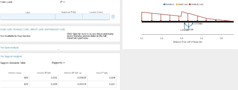

Can anyone help me check if this calculation works so far?
There are so many conversions between different units ..
The calculation is made by a free software but I assume that their calculation models are correct.
My own assumption is that the elevator is heavier at the front edge as there are hinges made of MIL 1430 N and since the lever and its attachment also are , there are also steel details on the other side and the rest is aluminum.
I have chosen to see it as a simple bar to begin with.
And the calculation is made to check which load the fixed joint must withstand for the elevator's own weight.
I intend to present it in steps so if I got something wrong I can adjust it before the next step.
If it's okay with you people?
Best regards Anna

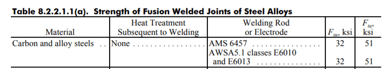

The reason why I have assumed that the only thing that holds this together is 23 x 1 is because the Accident Investigation Board did it.
I start with the same calculation model as them.
Namely I start from the same assumptions as them.
The lever is constructed of approx. 1 mm MIL 1430 N or more precisely MIL-S-18729C cold-rolled metal plates that are bent 90 degrees and then welded together to a rectangular tube, then welded togetherd with a round one.
According to the manual, repairs must be made in accordance with AC 43.13-1B.
Which states that AMS 6457 is to be used.
This is not a repair, but I assume it is the same welding material used in the manufacture.
The fraction is not in the weld, probably in the HAZ area, but I have ignored it because the Accident Investigation Board has done so.
What does Fsu, stand for?
I guess that Ftu, is ultimate tensile strength ..
Best regards Anna

The issue is that the 5 g is loading due self weight. So what's the weight of the elevator?
A pilots loading is meant to be 35kg pull or push (please don't get into if this is realistic) with a gearing ratio of x 5 that mean sit can apply 170kg on the elevator round numbers with a 1.5 safety factor.
so even if the elevator is 5kg which I would be utterly amazed at then that would be 25 kg at 5G. You really don't need much weld to hold 500kg which is why i suspect they have bypassed quite quickly that side of things.
V sqrt on the other hand if its against the stops at Vne and design limited at 170kg doesn't have to increase that much to go well over designed load without safety factor.
Mass = 6,758 kg
Weight = 6,758 * 9.81 = 66,3 N
Weight at 90 degress = 69,3 N , 0,0693 kN
G +5,7> 69,3 * 5,7 = 38,52 N
But the weight can be for both halves I became a little unsure now :-(
Maybe this helps? ..
/A
Albert Einstein

But if the weld can be calculated to hold for 352 * 23 = 8092 N (AMS 6457, 51 ksi)
And the reaction is R -0,0208 kN at the lever in this example, = 208 N
So it is not a problem as Alister says.
Then I would have 7884 N "to handle the rest" ??
