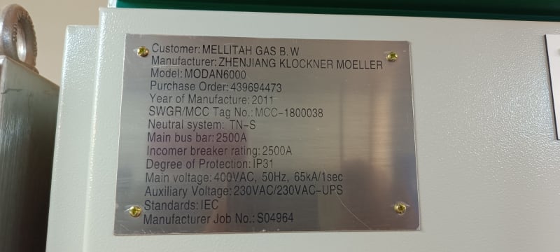

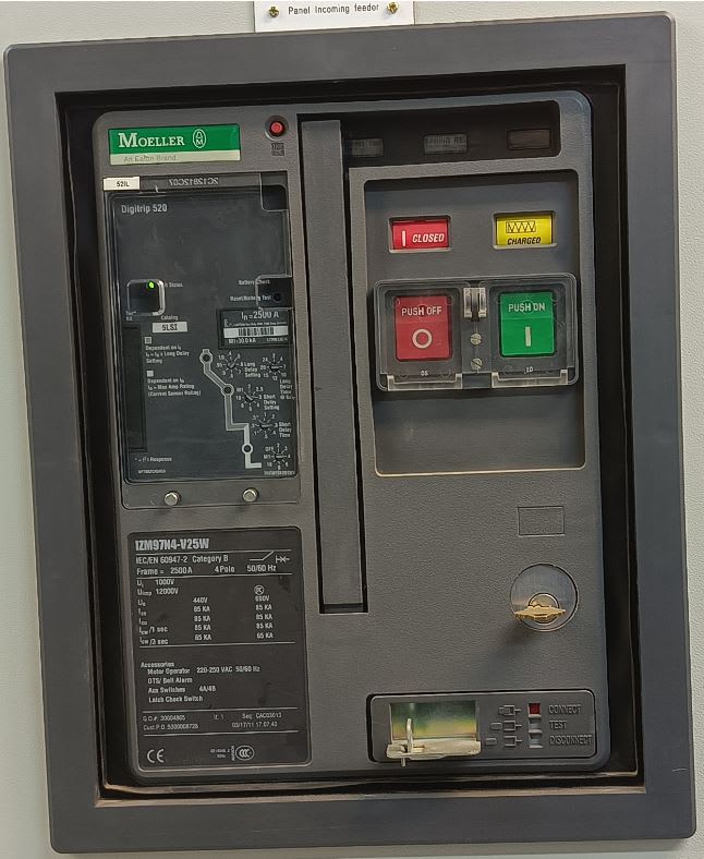

Yes thanks David, I can install one Control/Auxiliary Transformer 400/230Vac on the incoming of the ACB. On the Name Plate of Panel it is mention it as external supply from ups. But all these external supplies are far apart and not so feasible to arrange.
But What are the other potential solutions to address the issue of not having 230 Volts Alternating Current in the main panel to charge the spring charging motor of the Air Circuit Breakers when no neutral is coming from the transformer? One proposed solution is to bring a neutral from the transformer to the main panel, allowing for the provision of 230 Volts Alternating Current specifically for charging the spring charging motor. This solution would ensure that the motor can be charged automatically, eliminating the need for manual charging and potentially resolving any issues faced during that process. It is important to note that the rest of the system will remain unchanged, with the neutral not being distributed as all the connected loads are balanced. Additionally, the system includes 4-DOL motors and 8-VFD driven motors, each rated at 90 kilowatts.
Please see attached Panel Tag and ACB Pics.
