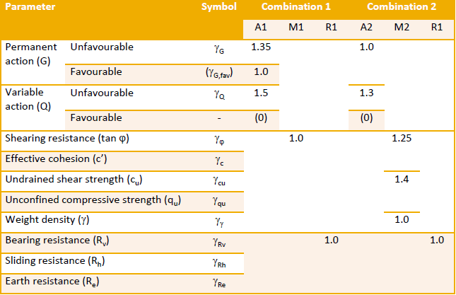

Dear kellez (Civil/Environmental)(OP);
The answer to your both question is yes...You are expected to calculate the friction resistance,overturning moment and sliding force with reduced cohesion (Cu with 1.4) and friction angle (φ’ with 1.25)...
With reduced cohesion and friction angle, the sliding resistance of retaining wall will reduce, the active pressure will increase..
You are expected to apply both of the above in the same load combination..
Just for clarification: My comment is valid for cantilever gravity retaining wall. In the case of underground structure,you should consider two combinations for design approach 1 (DA1). Partial factors will vary for favorable and unfavorable case..
 https://files.engineering.com/getfile.aspx?folder=e8edaa1c-1023-4ad1-80cc-35a7e5fdf103&file=partial_factors_for_ret_._wals,_ftgs_l.png
Hi, below is the picture of the table you posted above. I am familiar with this table which is from Eurocode 7.
As you can see, the table refers to only one Shearing Resistance (tanf), it doesnt say if it is Favourable or Unfavourable as in the case of Permanent Actions.
What i am trying to say is that in the case of a retaining wall we have two types of soil, 1) the base soil, which is resisting sliding and 2) the backfill which is causes Sliding.
In your first post you said i should apply the partial factor to both of the soils in the same combination, ok i do understand that, it also produces a safer design but are we sure
this is what the code suggests?
I will be asked a lot of questions for my design therefore i want to be able to justify everything.
