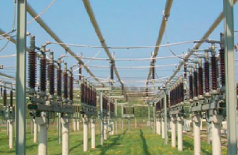

An educational lesson from the 136th Protection Sub-Committee Meeting where a kite string resulted in the loss of five 400kv transmission lines, two compensation reactors, and three interconnecting auto transformers where at most only 4 elements would have cleared.
I think this is worth bringing into the engineering and design arena as a serious discussion in that all to often busbars end up being so physically close to each other such that an event on one results in others being effected- the most notable resulting in the 2003 Denmark Sweden Blackout.
Starting on page 9. Other cases of total voltage level clearing also documented.
Regarding the Denmark Sweden blackout, a pentograph disconnect on bus A failed drawing an arc which evolved into a two phase fault involving closely adjacent bus B clearing the entire station interrupting a vital flow path which ultimately resulted in 5 million customer losing power.
With this said please leave space between bars, at least that of the width of a whole set, or the maximum distance which a protracted fault can reach before having the ability to evolve into another zone of protection. In addition to taking work space into consideration, where a grounded bus can be serviced without violating work distances between equipment/persons and energized parts.
I doubt flashover across horizontal spacing of buses (for first case), it is generally too large. It may be at the point where conductors from Bus-A (after disconnector) are under-crossing Bus-B. Clerances are less in vertical plane.
That is possible now that you say that, but I would imagine if the kite string had any metal in it, it might create an arc.
Good point regarding the vertical plane, that is another design issue that I see.
Synthetic kite thread being used these days is slightly conductive.
