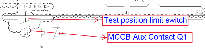

In the attached starter feeder control schematics, the control power to the starter is tapped from the line side of the circuit breaker. Interlock is made such that control power is unavailable when the breaker is off/trip.
So when the breaker trips -> control power unavailable -> contactor trips.
It seems that when the breaker trips, the contactor also trips. Is it desirable in the event of short circuit?
Unless I missed something, I don’t see that in your schematic actually. With the Control Transformer primary being tapped from the LINE side of the breaker, the breaker tripping will NOT drop out the contactor. That is not a good design in my opinion because it means that after a breaker trip event, as soon as someone recloses the breaker the motor could run and it might be unexpected, which is fraught with dangers.
Thanks Jeff. I missed that the control power was taken off ahead of the breaker.
That is probably a code violation and definitely a safety violation.

@Jraef, Yeah the schematic representation could have been made better, see the below image
Are you sure that that is not a circuit for a draw-out breaker? Test positions are common for draw-out breakers but not for Molded Case Circuit Breakers.
Ohm's law
Not just a good idea;
It's the LAW!
@Waross, by "Test Position" - here MCCB is mechanically locked in open state
I did miss the Q1 contact, thanks.
Bill, this is a typical diagram for an IEC style MCC, where the "buckets" have limit switches on the structure that are tied to a separate handle that, similar to a Draw Out Switchgear scheme here in NA, pulls the stabs off of the bus and put the bucket into a "test" position where the limit switches open the control circuit.

MCC starter and feeder buckets here in North America are different, we don't typically have that feature available, hence the confusion from people based here. I have worked for EU based manufacturers and been exposed to both types, but that is somewhat rare.
Thanks for the information, Jeff.
