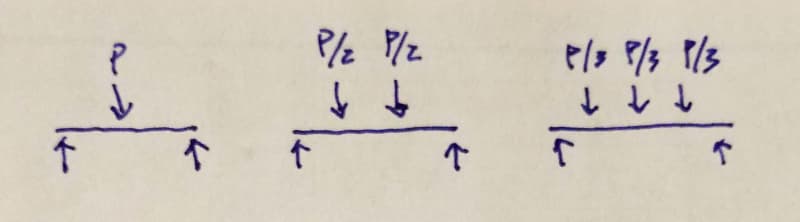

Does anyone know which beam has the highest moment for the same length? Is there a formula for multiple point loads?
Yes you have a linear structure so you can use superposition. So work out the moment along the beam for each individual load, and then add them together. Or, construct a shear force diagram and integrate it to get bending moment.

Is there a quick way to determine which one has highest moment? Or perhaps we can extrapolate from say comparing the denominator (one point load: M=PL/4, but I don't know what are the formulas for 2 or 3 point loads)? Thanks!
Do you know the formula for finding the moment in the beam due to a single point load in the middle?
Do you know the formula for finding the moment in the beam due to a distributed load along the length of the beam?
Which one of these formulas results in a larger moment (assuming total vertical load resisted is equal)?
As you keep dividing your point load up and distributing it along the length of the beam, it becomes more and more like a distributed load. So, we can say multiple point loads evenly distributed will result in a moment somewhere between a single point load in the middle and a fully distributed load.

You don't need a formula. My approach looking at the problem (since I didn't initially recognize thru intuition where along the beam the highest moment would lie) was to sketch out a shear and bending moment diagram:
[li]First sketch out your force distribution. It will consist of dirac delta impulse function for each point load (include your reaction forces as point loads).[/li]
[li]Then sketch out shear distribution as the integral of force with respect to distance along the beam. For your case no distributed load, the shear is constant between each point load and step-changes at the point loads.[/li]
[li]Then sketch out moment distribution - it is proportional to the integral of shear with respect to distance along the beam (proportionality constant depends on the beam... the same in all 3 cases)[/li]

Got it. I should have thought about it before: distributed load is essentially the same as having multiple point loads acting on the beam. Thanks, guys!
be careful if the image in your original post is accurate then stated another way the problem is:
Which has the peak moment:
- All of the load applied at the center of the beam
- 1/2 the load applied at the 1/4 and 3/4 points
- 1/3 the load applied at the 1/4, 1/2, and 3/4 points
Intuitively moving some load towards the support will reduce the bending demand on the beam, so option 1 will have the largest moment as it places all of the load at the furthest distance (moment arm) from both supports.

Yes, I've sketched out the moment diagrams. And 1 point load has the highest moment.
