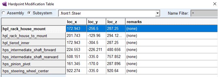

i have modified steering a default Adams/car steering model and i get a steering test in a front suspension model...
the parameters are normal, the suspension has no problems when i tested it separately.
when i modify intermediate shafts hardpoints to the location of the vehicle model, the Adams suspension analysis simulation encounters problems and the adams/car model closes and the window shows "Not responding"... so i can't see where the error happens...
but i know it happens when i modify the intermediate rear and forward shafts hardpoint locations...
also the pinion pivot itself encounters a warning when i change its hardpoint location but the simulation completes...
can you help me through this???
it is annoying. is there another way like changing the joints in the template so the steering can steer to the value of the angle that i want???
appreciate your help
these are my hardpoints:
is a joint replacement necessary???

Secondly you've got rather an incredible angle on your rear intermediate shaft joint, and your steering wheel is outboard of the ITR which is novel. Thirdly you've got a horrible angle on the pinion to ISF
Fourthly i don't use Car so i don't know what the second hp is supposed to be.

You might make it work if you replace all the Hookes joints with CV joints I suppose. I suggest you start with the running model, then move the hp half way to your proposed positions, and see if that runs.

It worked . I replaced hooke joints with convel joints and it worked.
one other question... how similar the hooke and convel joint performances are??? do they have similar effects on the system and will the covel joint do the same job as the real steering systems?
The fundamental problem is the phase angle on the I-Shaft is WAY off of a solvable geometry. That is why the cv joint works. You have a severe case of "lumpy steering" ! If the pinion and the end of the column are co-linear, you can usually find an appropriate phase angle for the I-shaft.
Phasing of Hookes joints is a handy tool for giving different on centre to off centre steering ratios, particularly now that we are using fewer turns lock to lock. CV joints remove that tuning option, which is good and bad. It's good in that people often get it wrong, introducing asymmetries in response. It's bad in that it is a useful option. CV joints are more expensive, tend to be bigger, hence harder to package, and have their own articulation limits. I suspect they'd have more friction, which is a bad thing to have in your steering column. I've never used them.
