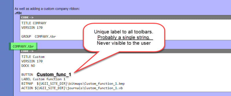

As well as adding a custom company ribbon:
.rtb:
Code:
TITLE COMPANY
VERSION 170
GROUP  COMPANY.tbr
.tbr:
Code:
TITLE Custom
VERSION 170
DOCK NO
BUTTON Custom function 1
LABEL Custom function 1
ACTION ${UGII_SITE_DIR}\journals\Custom_function_1.vb

Is there a good reason for this change ?
The UIF has changed quite a lot between NX8.5 and NX2007, in NX8.5 there was no "ribbon" but a more classic user interface.
the linked thread was posted 2014.
In NX 10.0 and later versions, there is the "Ribbon bar user interface" and as such it introduced a series of new files for the user interface.
The syntax is pretty similar inside, but they do different things.
.rtb creates a tab ( probably "RibbonTaB)
which refers to :
.tbr which are the groups on the tab ( (ToolBaR)
Which can contain :
.gly ( Gallery) which is smaller pulldown dialogs in the .tbr's
And there is also
.abr which is a "border bar"
which is a toolbar that docks along one of the sides of the graphics area.
As you have noticed , there is also the .men where the accelerators are set. It also controls the "Menu" pulldown + file pulldown.
Regards,
Tomas
